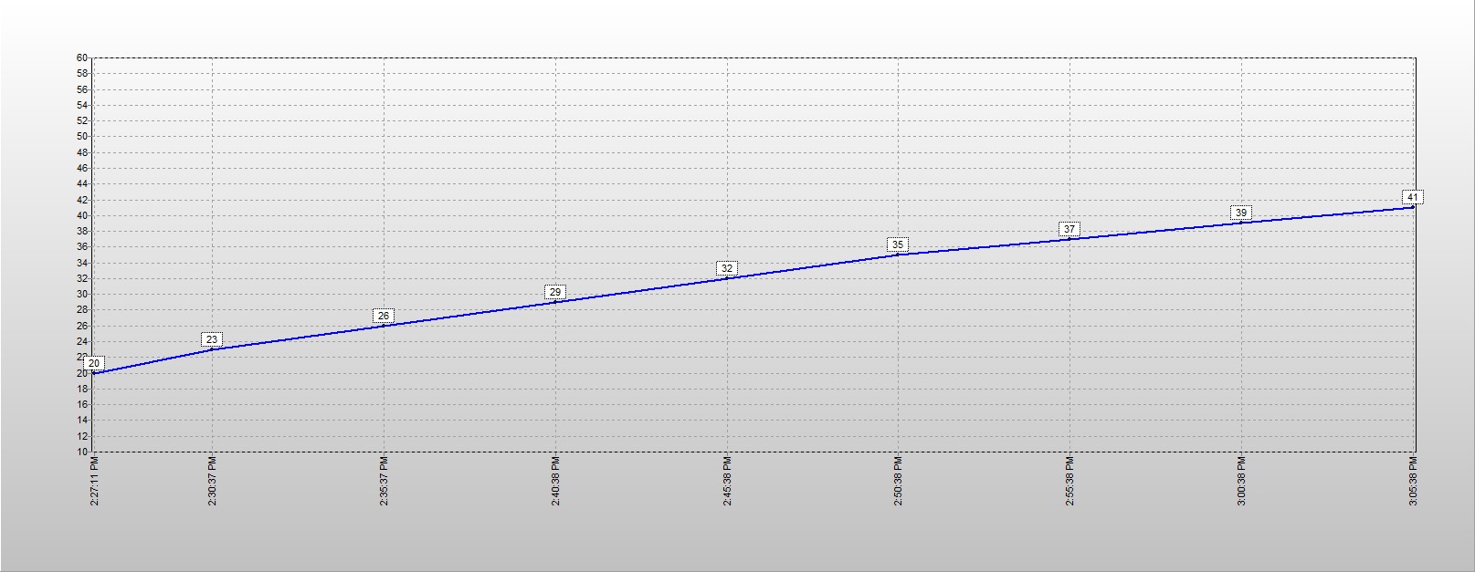

When i Sync it is normally 8-24 hours to complete with platter hard drives stacked on top of each other. So I have concerns about head buildup. I have an app that monitors smart attributes and when it alarms i come pause the sync but especially when i have to at some point sleep, it would be nice if this was baked into FFS.
Does anyone else share my interest in this feature?
- it should be able to determine which drives are being synced and only pause on those two. so if another drive is going critical that should not impact the sync.
- it should be able to auto resume when the temp subsides
I emailed some code snippets for windows and linux to the dev, already but what does everyone else think?

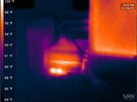

heatwatch begins (the eyes are the USB ports on the front of the seagate hub drive)
temp monitoring and throttling

58c is what I hit during this latest mirror operation.This, https://www.itprotoday.com/business-continuity/how-much-does-hard-disk-temperature-matter says:
