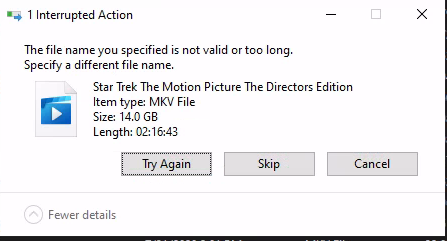

Looks like it is an OS issue. How bizarre.

I have no idea. In all my years of working with NT and NTFS, I have never seen anything like this. I tried copying it off the computer using filesharing and it gave up there as well. I shortened the file name, same issue. I have it playing in VLC to see if maybe it's corrupt somewhere.
