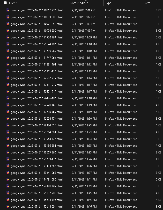

I just began testing freefilesync and it looks very promising, however I notice that the date stamp on the log files (that is the date the file was created, not the information within the file), is incorrect.
The log file dates begin with 12/31/2023 and increment from there.
If I delete all the log files, the new ones start being created with the 12/31/2023 date again.
The date and time on my pc are correct.
Any suggestions on why/how this might be happening?
I have attached a screen capture showing the issue.

With my FreeFileSync (FFS) v14.3 under Windows 10 the Data Modified is consistent with the log-file title, and the moment the sync finished.
So, is seems to be a specific problem, not a general FFS problem.
What is very remarkable however, is that although your Date Modified date remains at 12/31/2023 (for now?), the time keeps increasing gradually, first from 7:01PM to 7:02 PM, and then from 11:09PM to11:46PM.
No clues as to what may cause this, except for:
You seem to be running your syncs extremely close in time.
Did the previous sync actually end before starting the next sync?

The time stamp issue I have ultimately found to be a strange anomaly in my router that reset the clock, ignoring the frequent ntp update. The storage drive is connected directly to my router and I neglected to check the router clock when the problem surfaced. By manually resetting the clock that issue appears to have been resolved.
Not sure why it is running so often. It is currently set to back up a google drive (I am testing the program) and I have the delay set to 10 sec but I see no setting to control the frequency. My understanding is that realtimesync will run freefilesync whenever there is a change in the monitored directory, however, the vast majority of the log files state "Nothing to synchronize", so I am unclear why no action is being logged. It seems to be logging with each check regardless of the need to update anything. Is there maybe a setting to prevent logging when no action is necessary that I might have missed?
