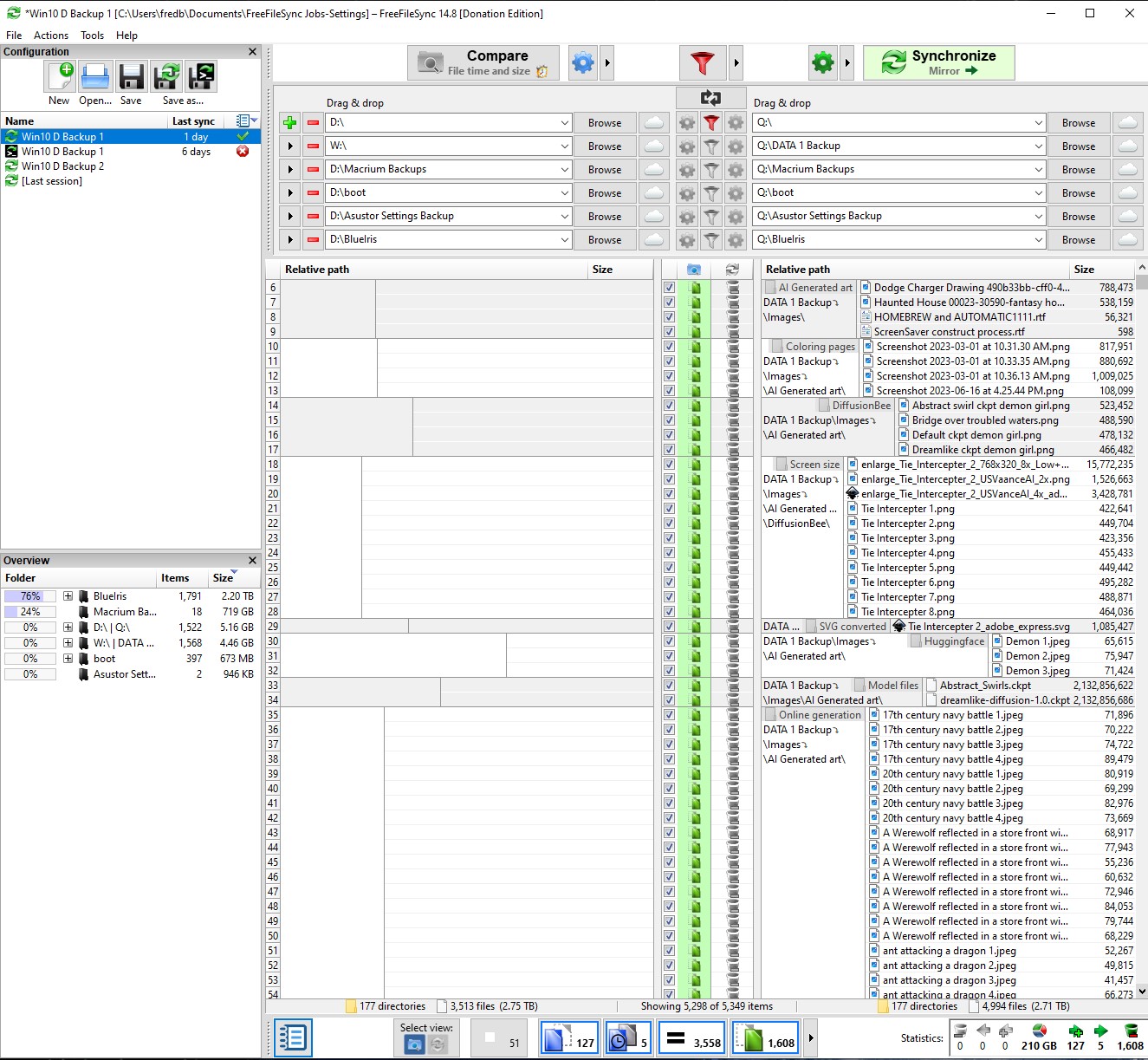

FFS-1 Screenshot 2026-03-09 092120.jpg ( says items not existing on source drive, plainly the comparison below shows this is not true)

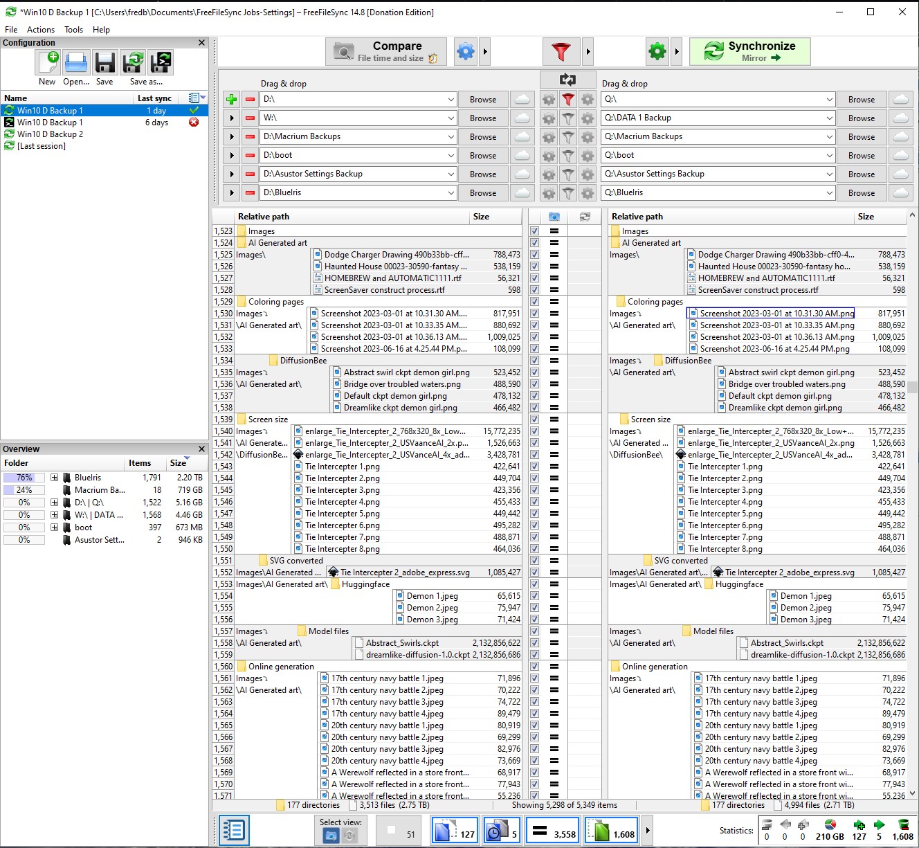

FFS-2 Screenshot 2026-03-09 092120.jpg (Shows files in question reside on both drives)
I am in the process of implementing a new backup system for a mixed handful of computers, Windows, Mac and Linux. The first rotation is almost complete so I started looking into how the second rotation would progress. I put the last disk from the backup set in to verify how the continuation of the backup would progress. I used the last disk so that there would not be too many changes and make it easier to go through,
I took a look at the Compare Report and was shocked that it shows conflicting information and after seeing this report I am concerned with what will happen the next time it is run to update the backup set..
Screenshots FFS-1 & FFS-2 are different line sets within the same report and is the reported state on the following day after performing the sync.
Report :
1. At the beginning of the report, ref. FFS-1, showing no files on the source drive ( item exists on right side only ) and set to delete the files that were just copied to the sync drive?
2. And then in FFS-2, beginning at line 1523, shows the same files listed above, residing on both sides and no action to be taken.
Concerns :
How can both 1. and 2. be true and actionable?
Which action will be taken, delete the existing files and quit,
delete the existing files and then copy the same files back and quit,
delete the existing files and then copy the same files back along with any new files and quit,
or something else?
According to the file totals and actions at the bottom:
2632 Files are equal
879 Files will be created on the right side
178 Files will be updated on the right side
3689 total files
- 2666 files to be deleted
1023 files remaining
Now unless I've gone totally bonkers, if this runs according to the information it has presented to me. This set will be totally out of whack.
What am I missing, other than my sanity?
Am I totally off my nut or what?

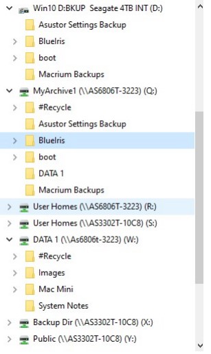

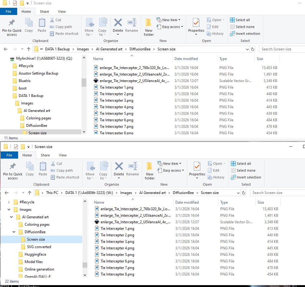

Additional doc set:
Directory Structure Screenshot 2026-03-10 162751.jpg Filters Primary Screenshot 2026-03-10 094320.jpg Filters D to Q Screenshot 2026-03-10 093747.jpg[/b] All actions are set as Mirror to Q: drive.
Data is on drives D: and W:, 2 different physical drives.
Drive D: is an external drive for Security and Backup Apps, attached to a PC.
Drives Q: and W:(DATA 1) are individual drives within a network attached 6-bay drive system, Asustor AS6806.
Drive Q: Is backup of Drives D: and W: and is changed daily on a 2-week rotation.
Drive W: is destined to house all of data files for the rest of the network machines.
My intent is to replicate the data of these 2 drives, D: and W: to Q: so that I have a rolling set of 2 weeks and a monthly set for 6 months.

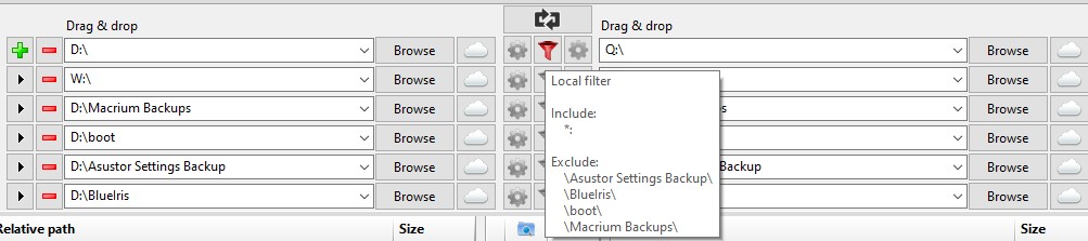

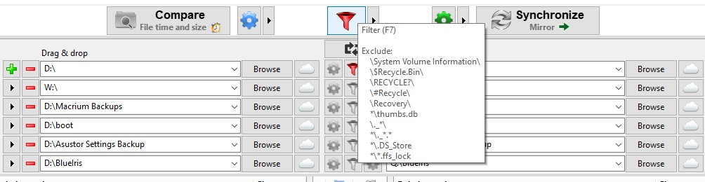

The Exclude filters I used:
Primary Filters: (Filters Primary Screenshot 2026-03-10 094320.jpg)
Local Filter D:\ to Q:\: (Filters D to Q Screenshot 2026-03-10 093747.jpg), Only the ( currently 5 ) files in the root of D: are copied to Q:\, all directories are excluded in this Filter .
This was done precisely in an attempt to avoid the situation you noted concerning Q:\Data 1 Backup. At least that was the intention. Did I miss something here?

The rest of D: is copied to Q:\ as individual root folders, as new folders may be added and some others may be removed/relocated over time. This is the reason for individual folder copies.
D:\BlueIris is the security camera system and writes data as it is created and then is replicated to Q:\ by FFS (actually it will be RTS once everything is worked out).
D:\Macrium Backups and all others are typically written and copied to Q:\ once per day.
Q: drive is to be rotated on a daily basis.
As per the FFS manual page on Filter rules:
If you just want to Mirror files in the root of D:\ to Q:\, and none in any of D;\ 's subfolders (other than those specified in your later left-right pairs), for your 1st pair you can use
• a Local Include Filter of simply *
• a Local Exclude Filter of just *\
As this Local Exclude Filter already excludes all subfolders of D:\ and Q:\, there no longer is the need to also explicitly exclude Macrium backups, boot, Asustor Settings Backup and BlueIris
Could it be that you did not receive the warning about the overlap,
"Some files will be synchronized as part of multiple folder pairs.
To avoid conflicts, set up exclude filters so that each updated file is included by only one folder pair",
because you are running the sync as a *.ffs_batch sync, rather than from the FFS GUI?
The Local Include Filter *: for your 1st pair will still Mirror all files in D:\ to Q:\, not just those in the root of D:\, which means you still have the experienced and described problem with D:\DATA 1 Backup not existing, consistent with the warnings in your log-file.Set *: as the include filter to match all files, but not folders. During synchronization some excluded folders will still be created if needed, but only if they contain at least one non-excluded item, that is, when they are not empty.
