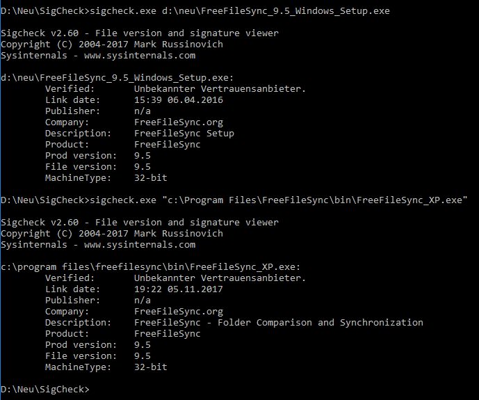

Can you check the signatures of the installer exe as well as FreeFileSync_XP.exe and see if they are valid?
Posts: 12
Joined: 29 Nov 2017
Micha_he
How can I check it ?
SigCheck from SysInternals ?
Why is "FreeFileSync_XP.exe" used and not "x64" on Windows 10 x64 ?
Posts: 7523
You simply could have right-clicked in Explorer, but sigcheck is fine. The signatures seem to be broken in your screenshots: They are not "verified" and do not show a "publisher".

Moment... again with SigCheck64:

Interesting. Your 32-bit version of sigcheck fails to verify the signature, while the 64-bit one succeeds.
In my test, the 32-bit version of sigcheck also succeeds to verify. FreeFileSync_XP.exe is also a 32-bit executable.
7dea96ea31b15d099a343a47c2d48e21 is the correct checksum.

D:\Neu\SigCheck>sigcheck.exe sigcheck.exe
Sigcheck v2.60 - File version and signature viewer
Copyright (C) 2004-2017 Mark Russinovich
Sysinternals - www.sysinternals.com
D:\Neu\SigCheck\sigcheck.exe:
Verified: Unbekannter Vertrauensanbieter.
Link date: 23:05 16.11.2017
Publisher: n/a
Company: Sysinternals - www.sysinternals.com
Description: File version and signature viewer
Product: Sysinternals Sigcheck
Prod version: 2.60
File version: 2.60
MachineType: 32-bit
ab35c68e263bb4dca6c11e16cd7fb9d8 *sigcheck.exe
ed6710178a009cb7c201ea86045f4604 *sigcheck64.exe

Okay, so the fact that 32-bit sigcheck fails even for Microsoft-signed executables shows this issue is not related to FreeFileSync. In your "dism" screenshot I'm seeing you're running an older version of Windows 10. Try updating to the latest one, which should print "10.0.16299.64".
