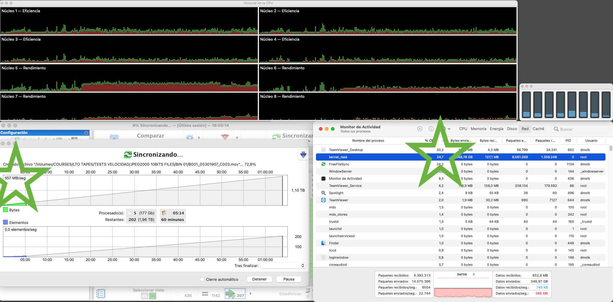

I have the same problem with new M1 Mac Minis, sending data over the 10Gbps network:
- From one raid to other Raid in other M1 Mac Mini or...
- To Google Drive, through the cache folder but finally comparing against the 'cloud' synced data
First I thought it was the hardware (OWC Pro Dock with 10Gbps ethernet) but the same happened with other adapter (Sonnet Thunderbolt 3 to 10Gbps ethernet).
As it was failing through FFS we tested Finder and the same data crashing was moved correctly.
The data transfer speed average can be over 300MBps with peaks of 620MBps (HDDs Raid 5 in both sides).
But at some point it crashes. Curiously the last 3 tests close to the same point after transferring between 720 and 740GB (from 800GB) and a test in between worked fine moving 989GB in less than one hour.
The failed tests were moving and average of 16,500,000 packets although the successful test moved over 21,000,000 packets and 293MBps.
Disks are not sleeping.
I installed last version of FFS and activated Rosetta, and restarted computer.
It is happening in the same environment and different countries with same M1 Big Sur Minis, OWC Raids, and 10Gbps ethernet.

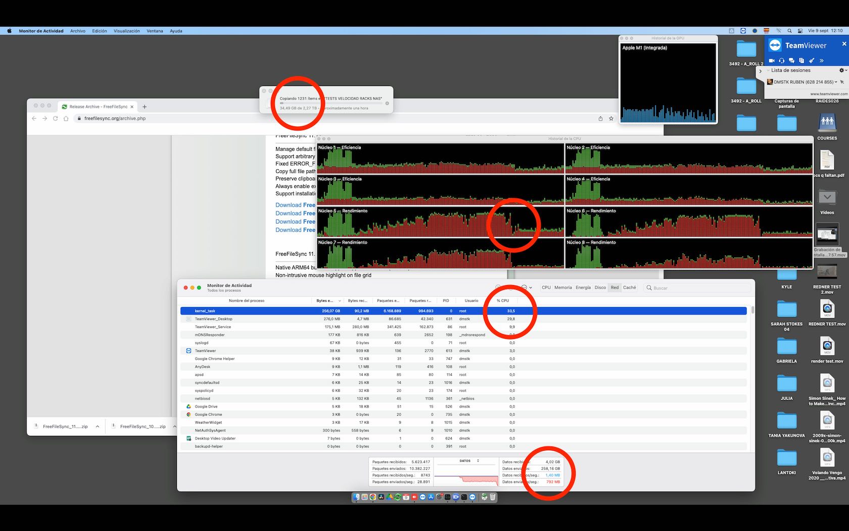

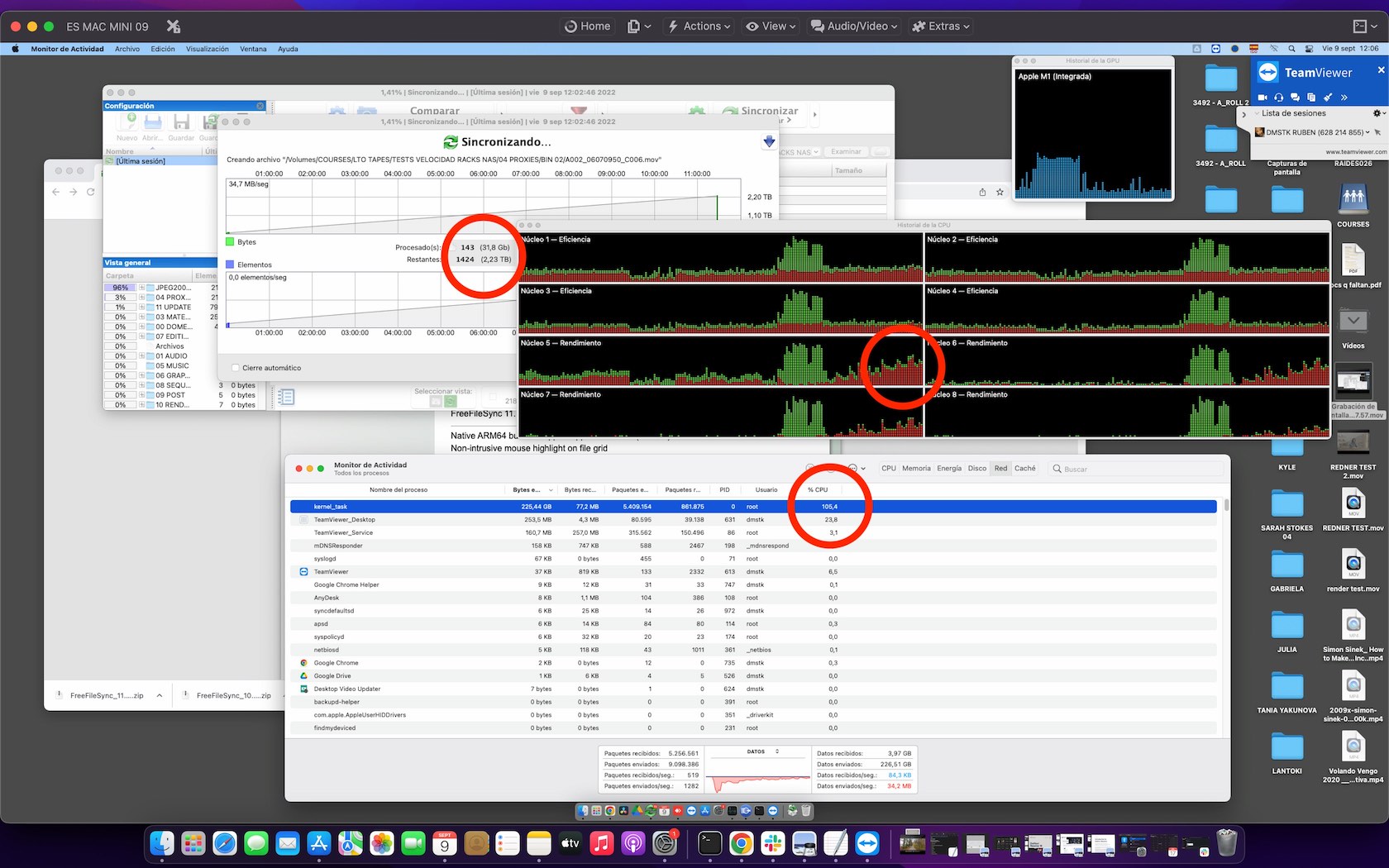

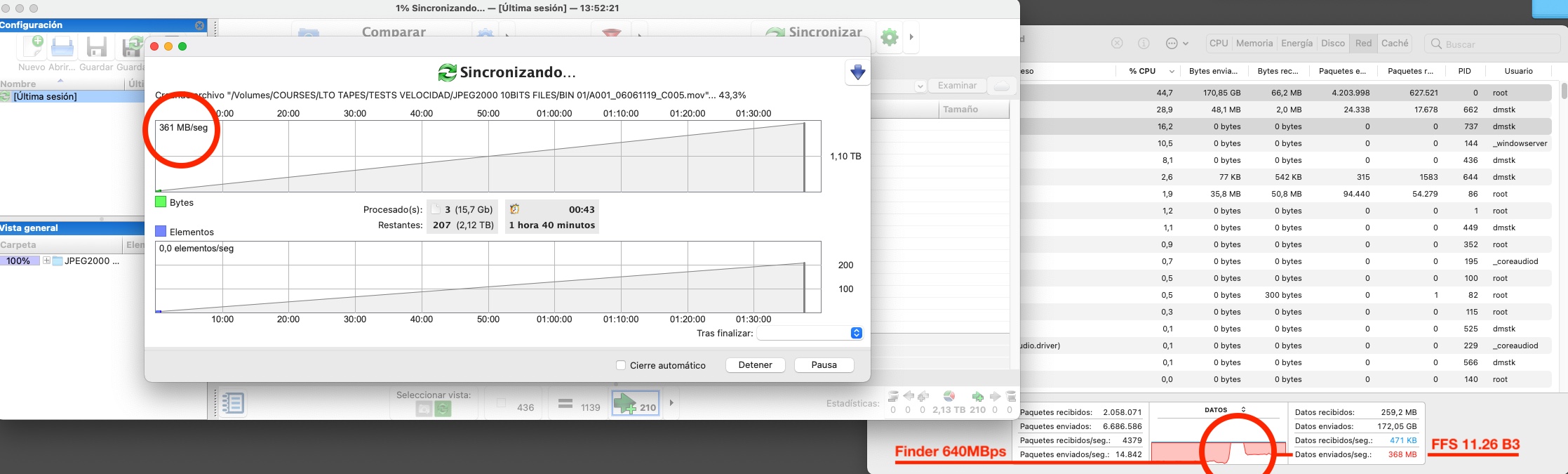

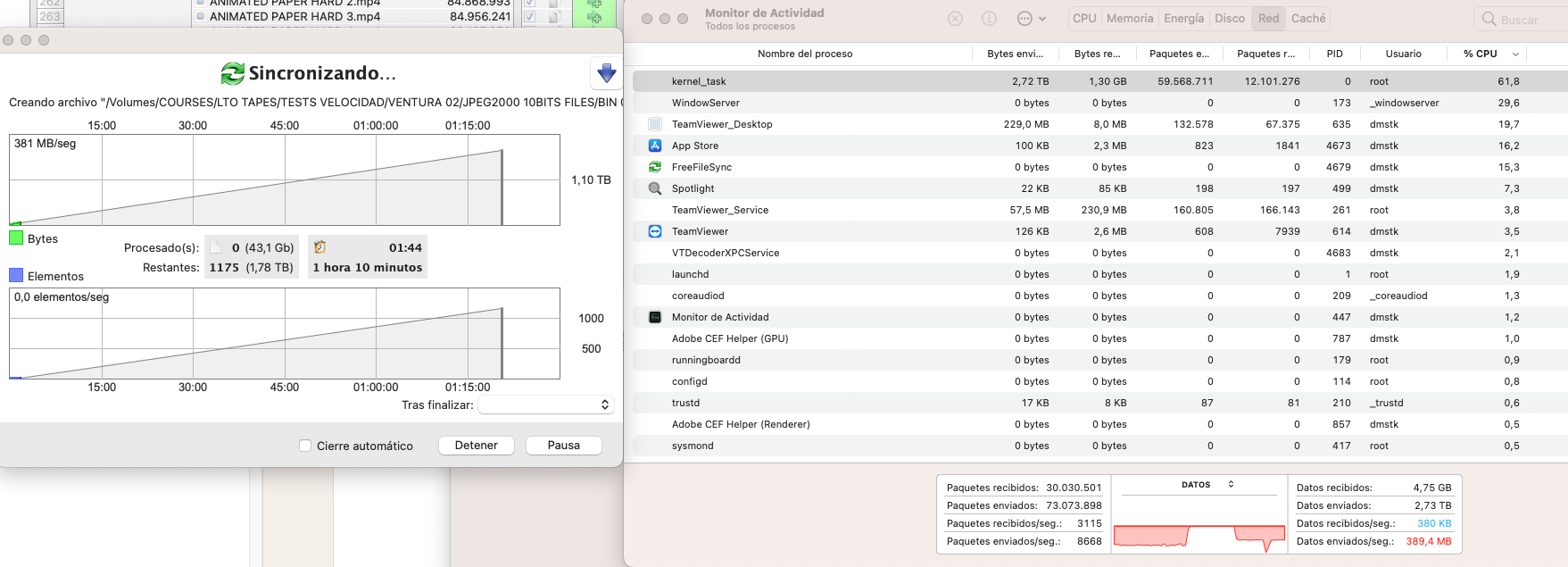

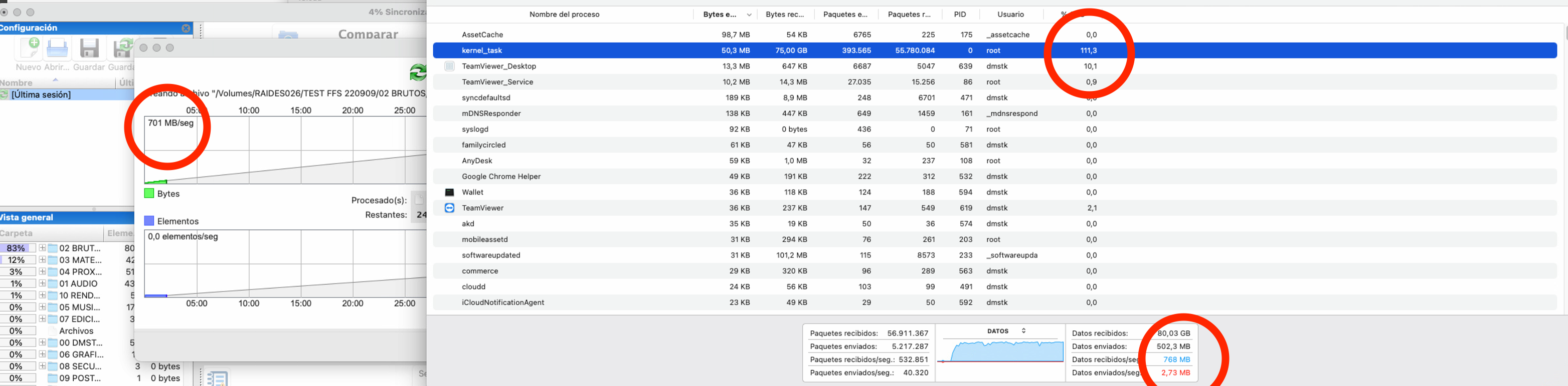

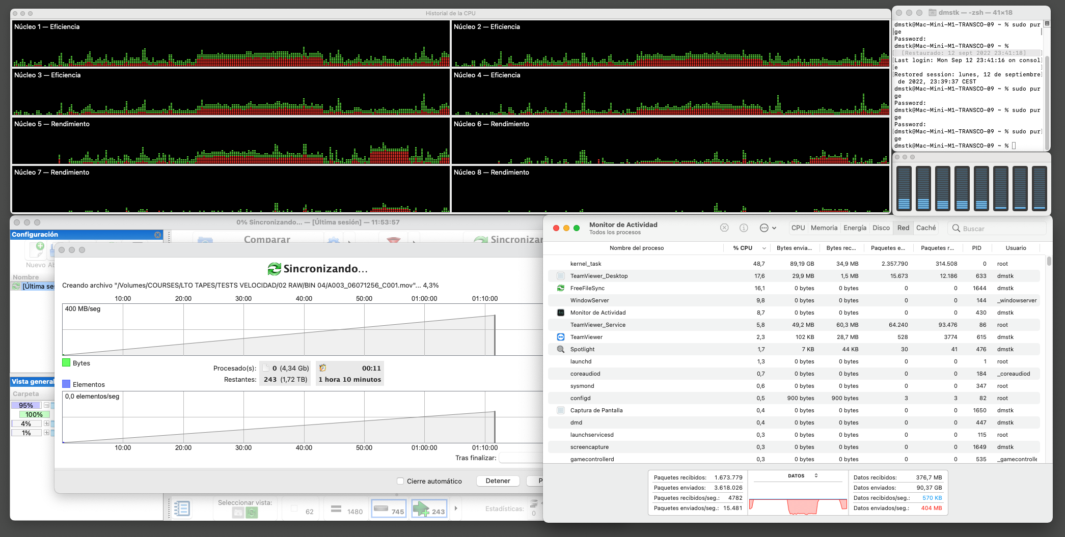

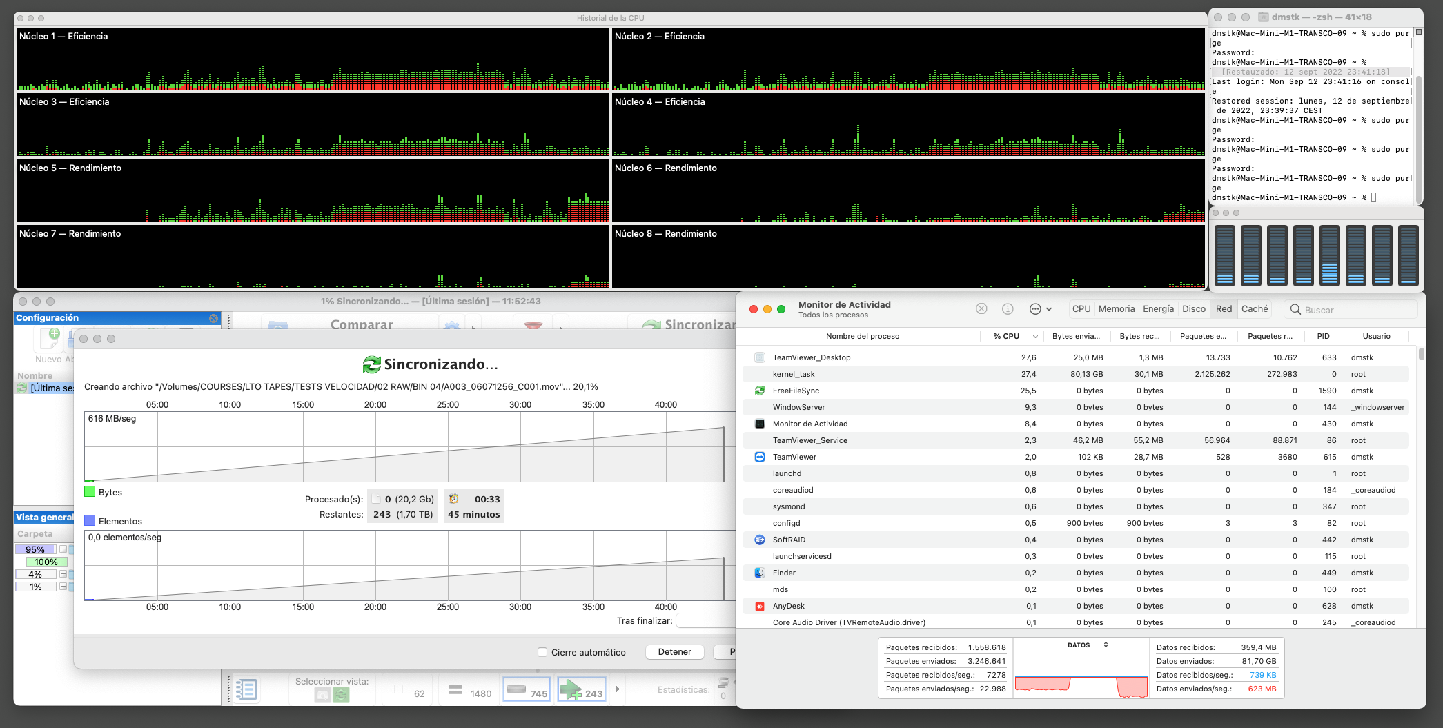

I have been testing again... Always the average is 30GB till the system starts suffering. And kernel_task increases the % till the computer hangs. See here:
In this screenshot the data transferred arrives to 30GB -as usual before crashing-, the speed is reduced to 35MBps, the CPU becomes red, the Kernel_task is over 100%.
But, after stopping FFS the system still is collapsing, till I decided sending the data with a copy / paste from Finder. Then the system automatically recovered and the high speed transfer kept. In our case through a 10Gbe getting close to 800MBs from a Raid 5 with 4 disks to a NAS:
In this screenshot I pasted the copied files to the NAS through Finder, the % CPU got automatically reduced, the data transfer speed is 792MBps, the computer didn't hang.
So no problem with Thunderbolt 3 ports or adapters to 10Gbe. No problem with Samba 3 or Samba 2 as I tried to manage. No problem with MTU for ethernet card.
I have been downloading and installing all the versions from the past and testing. The same issue and behaviour.
The version tested here is the 11.12, the first not Intel.
11.25 had the same bad result. Any suggestion?
- Posts: 21
- Joined: 7 Sep 2021
However, getting content from the NAS to the M1 is working fine:
So the problem is sending data from the M1, with the app, through the network but not with Finder
- Posts: 7535
@RUBEN SALAZAR:
Great testing and write up! From your descriptions it sounds like macOS is caching all copied data in the file system cache, even to the degree that the system runs out of memory and becomes unstable.
This clearly is a bug in the OS, but it's also something that FFS could avoid to trigger.
Here's a test version that doesn't write to the file system cache. Do you see any improvement?
https://www.mediafire.com/file/wztecf4aoqbgavj/FreeFileSync_11.26_beta_macOS%25282%2529.zip
- Posts: 21
BINGO! It keeps running without stressing the computer!! Yeah! You got the solution to people with M1s! THANKS!!
The only issue could be the speed, under 400MBps, while Finder is able to achieve 800MBps (in our case, reading from 4x HDDs Raid 5 and writing to a NAS).

- Posts: 21
Thank you so much for this beta testing chance!!
I have been testing, the app is stable in M1. Finder is still working faster, but I guess that verification between files 'is not free'. So close to 400MBps could be great for one touch process!
In the picture, Data sent with Finder, stopping, and syncing the same content with FFS 11.26 b3
And, yes, restarting computer before testing! THANKS! Any other improvements are welcome, and I am available for testing them!

- Posts: 21
In the picture, syncing from Raid 5 to NAS, while kernel is not in panic
It is working faster! CONGRATS! Now is achieving the speed of Finder.
I got 800MBps on weekend that the NAS was not working. I will stress it!
Curiously the 5th core is now working in its way

- Posts: 21
Thank you for this 5th beta. The behaviour is similar to 3rd. And winner is 4th!
In the picture, first installed Beta 5 and test, 400MBps average. Then overwritten with old Beta 4 and run, 600MBps average, the same as Finder copying-pasting
After testing 5th, re-installing 4th and testing, I re-installed 5th again and same result, going down to 400MBps again:
In the picture FFS Beta 5 second round. After first round I overwrote with Beta 4 getting the best performance.
