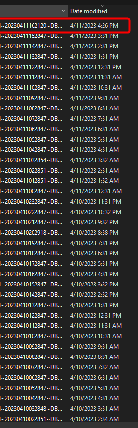

The issue is (this issue seems to exist across many 'Sync' programs I have looked at or used), inside of each one of those Dataset# folders, is a folder for SQL Database Backups (i.e. C:\Folder\Dataset1\DatabaseBackup) that is backed up each hour of everyday, but the DatabaseBackup folder contains 48 hours of backups (so, C:\Folder\Dataset#\DatabaseBackup\backup1.7z, ..\backup2.7z, etc).
So, I only want the newest "Backup%.7z" file out of that folder.

The DatabaseBackup folder will contain between 1 and 48 uniquely named files (So, the DataSet# folder will be unique as will each and every Database Backup 7z file - however, there is a very extremely small chance that I could end up with 2 Database Backups named exactly the same, the DataSet# folder will make the paths unique anyway). The DataSet# folder is also unique per 'server'.

The remote PC sets the file name. It does that via an automated SQL backup task. But for every new backup file created, 1 is delete. I only ever want copied on a scheduled task, the newest created file copied while removing the old file (so, basically a mirror of the "DatabaseBackup" folder but only for the newest backup.7z file).
