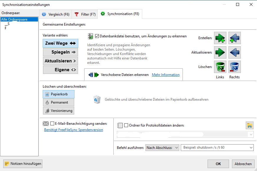

Just to add my Sychronisation-Settings, I include this screenshot
- FreeFileSyncEinstellungen.jpg (66.55 KiB) Viewed 1785 times
- Posts: 4911
https://freefilesync.org/manual.php?topic=synchronization-settings
Sounds like you might be using a filesystem that doesn't have stable IDs
- Posts: 7523
- Posts: 9
- Joined: 2 Feb 2023
I find a file named sync.ffs_db in each of the directories.
Suprising point is that one of these files does exist, but has no entries in the properties: "created","last modified" and "last access", while the other have these properties filled.
What does that mean?
The distant directory ist a SMB-directory mounted in windows with drive letter.

- Posts: 7523
File IDs are not relevant to the OP's problem. Detection and propagation of ordinary CRUD operations only requires sync.ffs_db files. This will start working with the second sync, i.e. when DB files from previous sync are available.In filesystem like NTFS, each file have a file ID, reside inside the MFT file record of each file, no matter how you change or move the file on the same NTFS volume, the file ID would remain the same.
FreeFileSync use the file ID provided by the filesystem and store it into the database file sync.ffs_db, to trace file move or rename, if you have read the manual of FreeFileSync carefully, there is clear explanation of how this feature work and its limitations.
>>> Synchronization Settings <<< harryytm, 24 Jan 2024, 05:32
