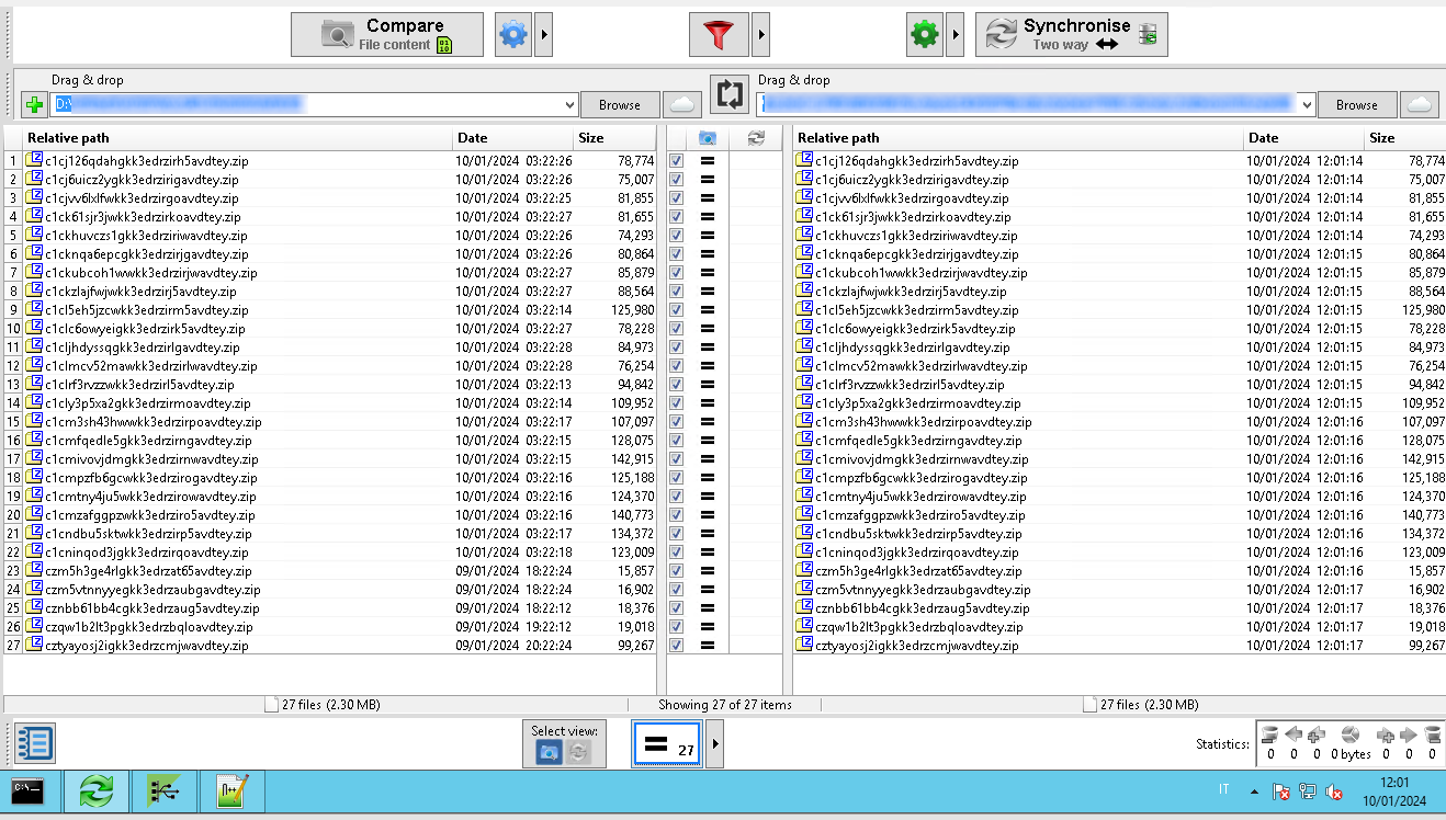

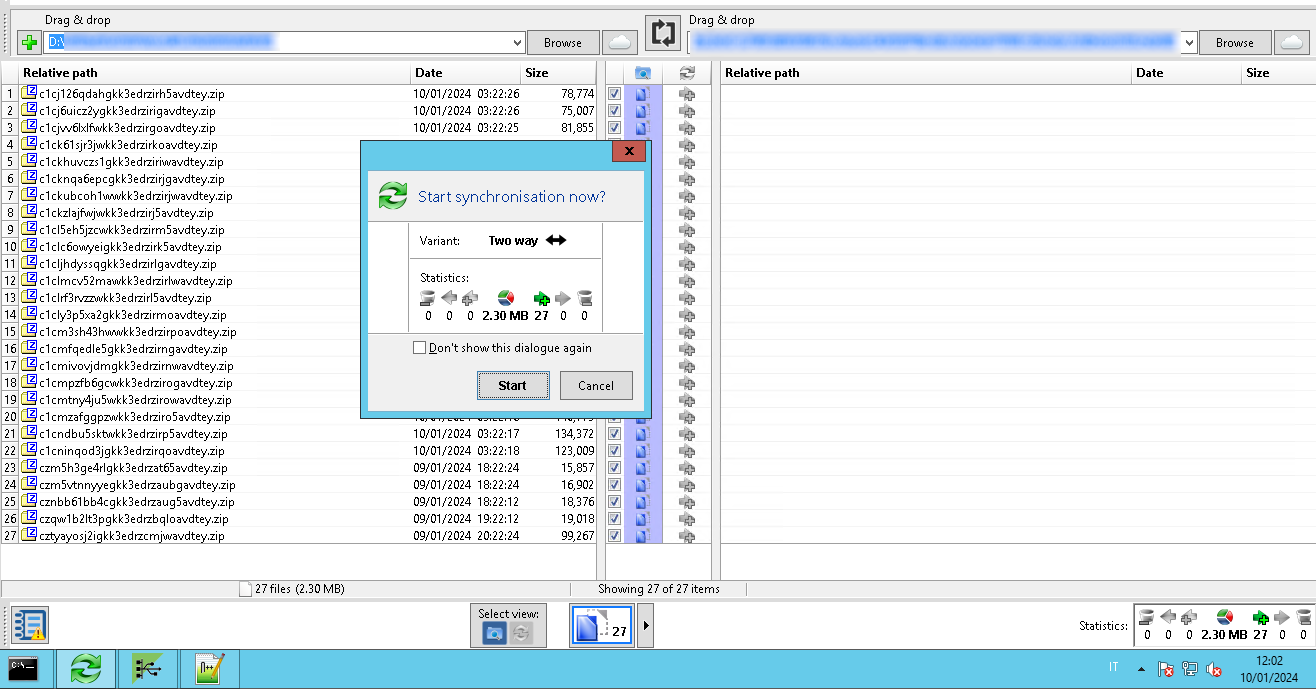

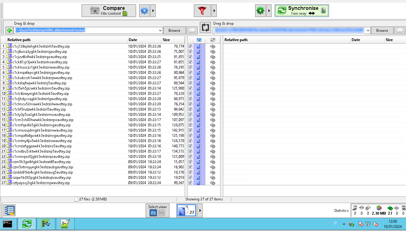

I'm using two-way sync to upload files from a local folder onto a remote SFTP folder. On this folder, another user is picking up the files and then deleting them. When the deletion occurs, I want the local files to be deleted as well during the next sync.
I tried "File time and size" comparison in the past, it works well if the clock of the SFTP server is the same as the local one. However, in this case, the SFTP server is not synchronized and I cannot ask them to sync it.
So, following the manual (https://freefilesync.org/manual.php?topic=comparison-settings), I tried with both "File size" and "File content" comparisons, both unsuccessfully. Every time the other user deletes one of the files I uploaded, FFS detects it as a new file and it tries to upload it again, instead of deleting it from my local folder.

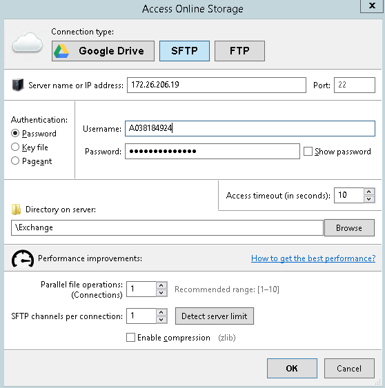

Thanks, I think I understand now. The remote SFTP has got a root directory which is not writable, then a writable child directory where I upload the files. I believe that the issue is that FFS is trying to store the DB file in the root directory, right?
If yes, since the child dir is already specified in the connection path, shouldn't FFS store the DB inside that child dir? Or is there any way to force it?
Many thanks again. Cheers, Luca

Then I don't understand it. The writable directory is already selected on the main dialog, it's declared directly in the SFTP configuration:
I also tried to manually upload a text file renamed as sync.ffs_db just to check possible blocks on file extensions etc. but it was uploaded correctly. What else could it be? Thanks!
