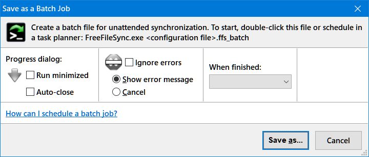

No, it's not saved as a batch file (those are attended, right?). I have 2 batch files that run minimized & autoclose, but several that aren't batch files. However, the result dialog box closes & doesn't make a sound, even though one is set for comparison.
If I choose, Save As..., this dialog box opens: (although I don't want an unattended batch file, so I haven't saved it as a batch. Also, this is what options I have chosen:

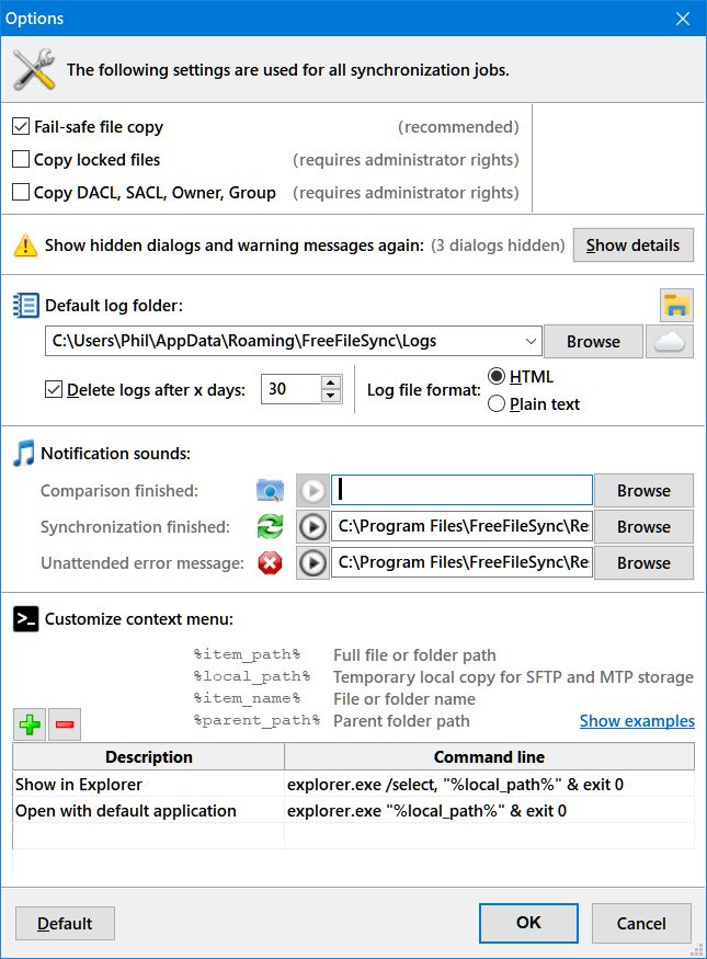

The latest screenshot shows "3 dialogs hidden". One of them is likely the results dialog.

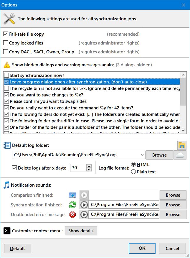

Thank you Zenju for Post 7138!! You're right. Of the 3 dialogs hidden, I had to change the 2nd from the top to this:
Now everything works the way I wanted & the sound is back when synchronization finishes.
