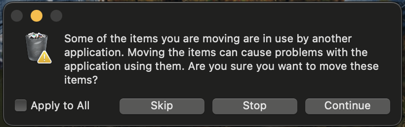

Like I said before, I was able to delete the lock files, and eventually I was able to figure out how to change the permissions back to allow me to both read AND write to the drives. So, I am basically back where I started. I uninstalled and reinstalled FFS and attempted to use FFS again to compare the Target Folder in the two drives, but when I start the compare, it just freezes up my entire computer and crashes the program. I decided to go back to doing it the old-fashioned, manual way (dragging & dropping), but once again, I don't know which files have been successfully copied to DriveB and which ones haven't. Those 7 files I attempted to sync earlier are now corrupt. Every time I attempt to copy & paste or drag & drop them from DriveA to DriveB, it just sits there and says it's preparing to copy, but it never does, and eventually it goes to the spinning beach ball of death, and I have to completely restart my computer. I also cannot even delete them from DriveA. When I attempt to, it gives me this error:
At this point, I was so frustrated with FFS that I just ended up completely uninstalling it from my computer because it was useless to me, not being able to run either a compare or a sync job since it just freezes up. Also, I figured maybe uninstalling the program would fix the issues entirely, and mostly it has, but the 7 files are still corrupt (which isn't an issue, I have them backed-up to a third location), but I am just confused what is going wrong. Am I doing something wrong? I would really, really appreciate any sort of help from anybody who thinks they could possibly help me!
