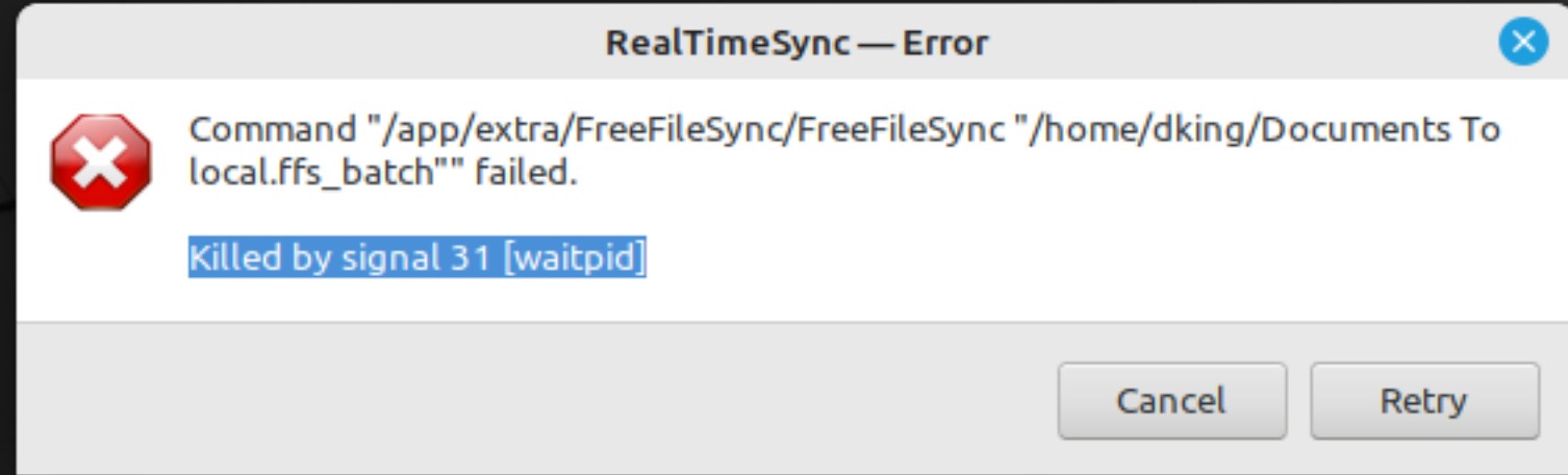

When I set up RealTimeSync I get errors as soon as it detects a file change.
Killed by signal 31 [waitpid]
Any suggestions?

RealTimeSync Linux Mint Killed by signal 31 [waitpid]
signal 31 = SIGSYS
which is documented as "Bad system call (SVr4); see also seccomp(2)"

OK,
Problem solved. I decided to do a clean install of Ubuntu, which does not support flatpak, or have FreeFileSync in its software repository.
I downloaded the installer from here, and it works.
So, I uninstalled the Flatpak version from Mint. Did a reboot, and a clean install of FreeFileSync from the website and its now working.
Something about the flatpak version was causing it to fail.
