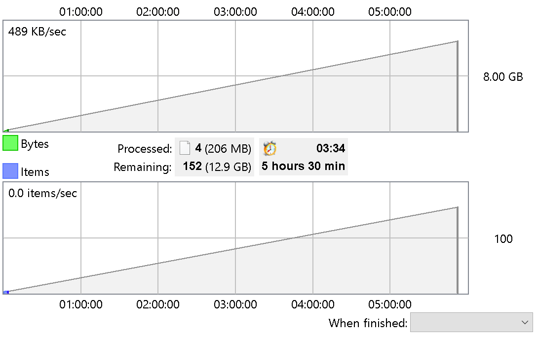

I recently bought a usb 3.1 flash drive and created a new sync for it with FFS.
When I try to sync it is extremely, see picture.

- Posts: 2997
> ... so before syncing for the first time I copied all the files in Windows Explorer ...
As FFS copied 206MB and still intends to copy 12.9GB, it seems that, unless the changes to your left-side location are quite substantial since your copying in Windows Explorer, FFS intends to re-copy the entire contents, rather than just the modifications.
Are you sure the left- and right-side locations in FFS match with your Explorer copy?
Run a Compare in FFS and check if the proposed sync actions match your expectations.
And only then run your sync.

- Posts: 4934
According to PNY's website and specs: https://www.pny.com/en-eu/attache-4-3-1-usb-flash-drive?sku=FD512ATT431KK-EF
The max write speed is 20MB/s for the 512GB version.
Sounds like a cheap flash drive performing like a cheap flash drive. It probably has a cheap controller, cheap NAND, and bad thermal management. This is not to say PNY is bad or it's a bad flash drive, but it looks like your needs require something more advanced than what you have.

The SanDisk will write almost 400 MB/s forever and ever, it is my daily driver. The SSK is about 350 MB/s for about 80GB (for the 256GB version), then the cache fills and it goes down to 80 MB/S. It is a lot cheaper than the SanDisk for that reason. Read speeds on both are similar, ~350 - 400 MB/s

I see.Sounds like a cheap flash drive performing like a cheap flash drive. xCSxXenon, 30 Mar 2023, 16:17
But the drive performs enough for my needs (backup) under Windows Explorer. Copying a 2GB file directly doesn't take 2-3 minutes like it does when using FFS.
- Posts: 4934
FFS probably transfers that same 2GB file just as fast, but your initial picture is not showing 2GB files, it is showing 156 files around 84MB each. Are you sure FFS is slower when you are testing the exact same file(s)?
