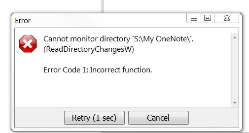

My case - left is a network folder mapped to a drive letter S: right is a folder in a system. RealtimeSync.
After I click the "Start" button in RealtimeSync, appear the error message:
Cannot monitor directory 'S:\My OneNote|'.
(ReadDirectoryChangesW)
Error Code 1: Incorrect function
What is a solution?
Regards!
What is a solution?
Regards!
- cannot monitor directory.jpg (18.72 KiB) Viewed 4261 times
- Posts: 7523
"If the network redirector or the target file system does not support this operation, the function fails with ERROR_INVALID_FUNCTION (== Error Code 1)."
The "solution" in this case was to not monitor this directory.
