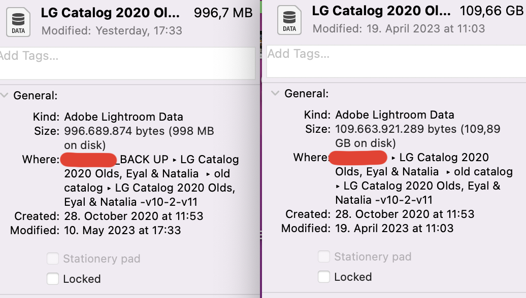

I am trying to make a backup as "mirror". but I found those 2 files are significantly different size and FFS says no differences...
Anyone know how to fix this... that would be really appreciate it...
FFS not detecting size differences

Kind of. FFS may only be syncing/transferring <100% of the actual content, because that excluded stuff doesn't matter or isn't transferrable anyway, meaning less space will be used in the destination.
Since your picture is showing Adobe Lightroom data, there is likely a lot of junk/cache in there that is excluded.
100GB vs 1GB is a large difference, you are right about that. Looking further into it, I am noticing that you are having this "issue" with a single file, not a folder. That is interesting because FFS wouldn't ever alter a file's data/content. I would make sure that you haven't excluded that file in the filters somehow. If not, it's possible that Finder is not correctly reporting the size of the source file. What happens if you manually copy that file to the backup?

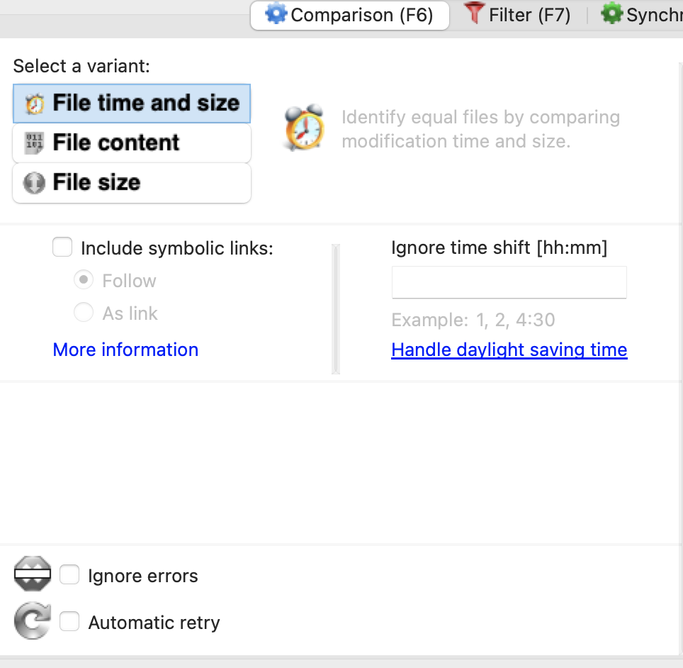

my comparison was like this (attached photo) but I re-made "Configuration" and now every data sizes are same now!
