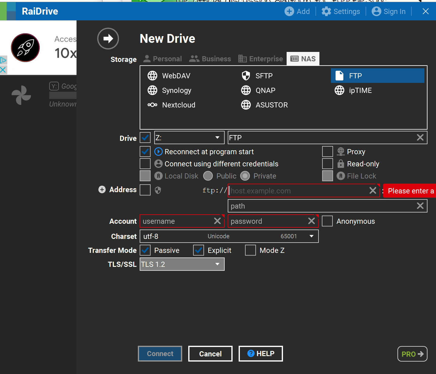

I think you might find it helpful if you mounted a drive letter to the ftp server and then used that drive letter inside free file sync. This would be your windows style. It would be because it would be recognizable inside windows. File Explorer as a drive letter.
You Can do this for free with raidrive and rclone. I'd try raidrive first cause it's easier to use and supports ftp mounting to a fixed drive letter in windows file explorer. I think this is what you were referring to when you said windows style FTP.?
You can assign whatever drive letter you want that you have available in windows and then have free file sync. Search that drive and sync that drive instead of trying to connect to the windows ftp server from inside free file sync.
This should cure your problem.

LeoW
paulo88,
Is F: the local drive where the data is on the Windows FTP server?
I'm in the process of loading the windows ftp server software on one of my computers so I can test what you are trying to do to see if I can assist further.
Have you been able to test out mapping a drive letter to the FTP server using Raidrive? It might work for your situation. If you Must include the letter f: in the URL, try using both f:\ and f:/ one will be wrong. Also can you ask someone in IT for help formatting the exact URL required to connect?
As you can see in the picture, The URL and the path go on two separate lines which may work better.
It's real easy and I use it for SFTP at times. I need it mostly for Onedrive as I have more than one account, and Windows only lets you connect to a single personal Onedrive.
Rclone works too. It's just a bit more difficult to learn to use.
