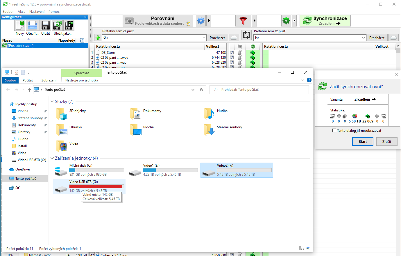

I want to synchronize two identical disks, each 6TB in size. One is almost full (there is 142GB of free space). The other is completely empty, cleanly formatted. Both drives have the bins drained. When trying to copy, FreeFileSync shows 5.50TB of space occupied, more than the disk size shown in Windows Explorer. I also tried turning off the safe copy feature, but this had no effect on the size of the data being copied.
Thank you for your help.
Regards
Jan

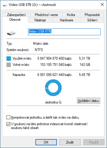

The discs are formatted identically - see attachment. And they are exactly the same type. One has data on it and cannot be copied to the second disk.
In the properties of the G: drive, what is the 'size on disk'?
Also, you may not have followed the link I posted, but there are some possibilities in there
- Posts: 5
- Joined: 23 Jul 2023
The G drive properties do not specify the size on the disk. I followed the link you posted, but found no solution.
Run WizTree on that G: drive. Then we can confirm if Windows is off its rocker again
two identical disks
Thinking the first is incorrect.FreeFileSync shows 5.50TB of space occupied, more than the disk size shown in Windows Explorer
Thinking the second is correct.

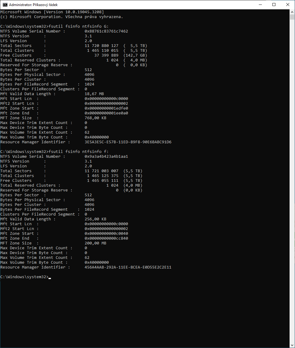

While the may both be "6TB", while they may both be the same "brand", there is difference between the two. (At the least, total sectors is different.)
And the latter message is also likely correct? (May also be correct?)
You're looking to copy "everything" from G: to F:, but "everything" on G: takes up more (albeit very little more) room then there exists in free space on F:.
Exclude "something" from G: (enough such that FFS no longer complains) & your copy should then proceed (without warning). (Or, you could say "ignore" to that message, & "all" will copy - but not entirely all, something [theoretically] will not fit.)
And that said, it is still kind of weird, because G: is not full, using only 5.31 GB of space (which theoretically is less then the available free space on F:).
I suppose your file sizes could also be playing in. Cluster size is 4096 bytes, so a file of 1 byte will actually require 4096 bytes of disk space (1 cluster) [slack space] [& aside from the case where small sized files may end up in the MFT [is it?] instead].
Looked at another way...
(G:) 1465110015 clusters - 37399889 = 1427710126 clusters in use
(F:) 1465055111 free clusters
