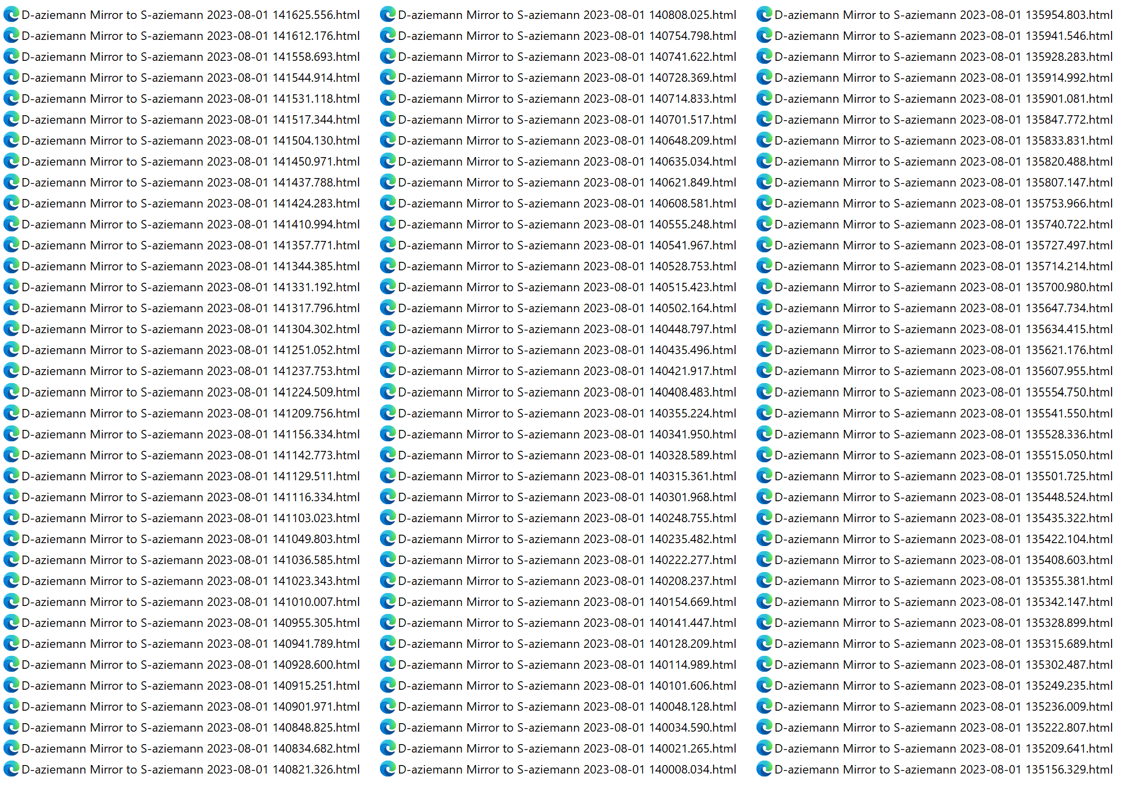

My Recycle Bin (Windows 10) is inoperable because of thousands upon thousands of files like in the attached. I have tried multiple approaches to emptying (all at once, selecting a few at a time etc.) but there are literally so many of these that I have not found a method to get my Recycle Bin back and operating. Any suggestions on to get these emptied out and how to prevent future overloading of the Bin? Thanks.

You could open FreeFileSync with admin rights, select only one folder, "C:\$Recycle.Bin", and manually delete all the items. ("permanently", of course)

Thanks. My computer skills may be lacking to execute on this. I ran as administrator, but only arrived at the same main FreeFileSync screen. I did a search for C:\$Recycle.Bin but that came up empty, even though there were thousands of files out there. I had set reports to go to my D drive (where I keep data), changing to 30 days max, but that still overwhelms the Recycle Bin and Empty Recycle Bin no longer worked when overwhelmed. So, what I ended up doing is selecting 150 or so files at a time and deleting them in batches from the Recycle Bin. I don't know if I will have to Empty frequently to avoid the bin getting overloaded. Or maybe there is a way to limit how many files go in there and/or a setting to automatically delete outside that range?
Why 150?
Can't you select them all, Ctrl+A (to select them all, then Shift+DEL to delete them)?

Just right-click the Recycle Bin icon and empty it, no need to go inside it first. If that isn't working, there is something wrong with your OS or the drive itself

Thanks. Prior to the FreeFileSync files, I was able to delete all at one time (including lots of 4k video and other large files). The problem started once the FreeFile Sync files started appearing. When I would try deleting all, it would search forever and never finish, no matter which method was used to select. That is why I experimented with a smaller batch. That was the only way I could eventually empty out the recycle bin?
