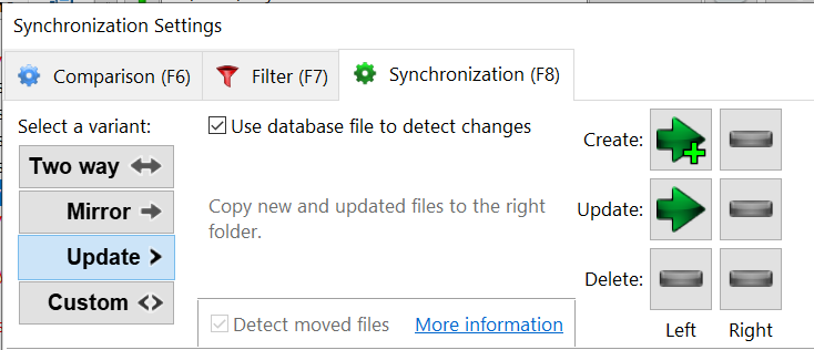

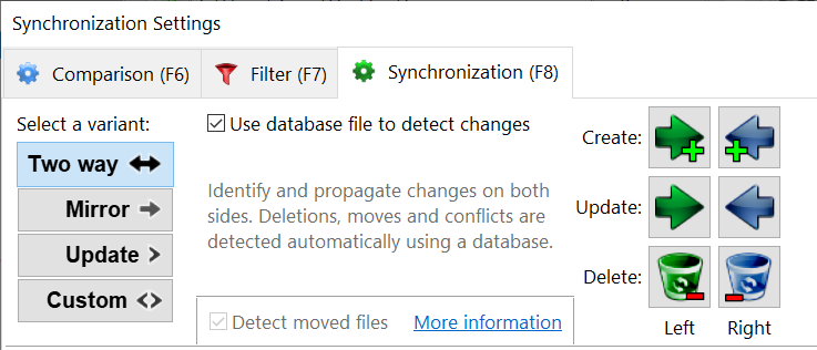

- Joined: 12 Feb 2021
I don't quite understand icons showed in mirror mode with database on in version 13.
FFS shows something like this [left/right]:
create: ->+ / trash bin
update: -> / ->
delete: trash bin / ->+
I thought mirror should be rather:
create: ->+ / ->+
update: -> / ->
delete: trash bin / trash bin
Is this some kind of mistake (wrong icons) or I just don't get the idea? I'm using mirror for a long time, but those icons showed recently and made me wonder if anything has changed how mirror works.
update: -> / ->
create: ->+ / ->+
update: -> / ->
- Posts: 4941
Each row corresponds to an action. If you create something on the right side, it will be deleted as shown in the matching row/column intercept. Updating a file in either the left or right side will cause FFS to mirror the left file onto the right side. And on and on
Ok, thanks, now I get it. Left and right row/action should be watched separately, not as combined process such as if I create something left it will be deleted right ;)

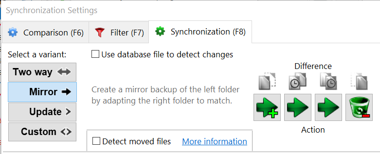

- Joined: 3 Nov 2023
Please change the part where you can set what happens on certain differences back to pre ffs13.sync-cfg-mirror.PNG Zenju, 24 Aug 2023, 09:56
It was so easy to understand what you do with these icons in previous versions because of the tooltips and so on, now i dont get it at all.
This was perfect: https://web.archive.org/web/20230102234323/https://freefilesync.org/manual.php?topic=synchronization-settings
