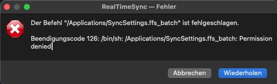

Helllo. After installing Mac OS Ventura and updating Dropbox, the manual Freefilesync works, but the Realtimesync does not and I get this error message. I tried a myriad of things but nothing helps.
Thanks for any help
Beendigungscode 126; Permission denied

So you can run .ffs_batch directly, & that works.
But when you use RTS, the .ffs_batch fails with a Permissions denied.
What version of FFS?
Any change if you test with the older 12.4?
https://freefilesync.org/archive.php

thanks for the kind reply!
that is correct.
I do use the 12.5 donation version (updated it from 12.4 because I hoped it would solve the problem).
I did grant any possible "permission" in the system settings. Deleted them, and granted them again (just in case).
Thanks!
that is correct.
Thanks!
