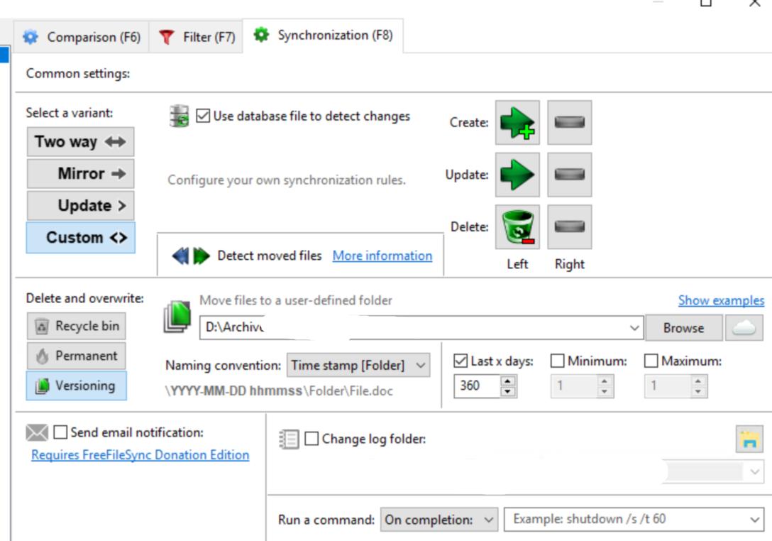

I`ve configured batch run for 4 folders which are syncing to 4 different folders with archiving all changes to own paths.
But after saving batch run and adding to real time sync auto run doesn`t work, every time I run it manually.
Configuration setting see in attach (archive paths different 4)
I will be grateful for any help!

Your problem description is not very clear (at least to me), particularly the part "auto run doesn`t work, every time I run it manually."
Also not clear: "archiving all changes to own paths"
This suggests you would use local sync settings, with a specific Versioning location per left-right folder pair. However, the image you show suggests you use global Versioning settings.
Or, perhaps your problem is simply related to this.

Hi Plerry, sorry for the unclear explanation
In my case:
\\server1\folder1 -> D:\folder1; Versioning on D:\Archive\folder1
\\server1\folder2 -> E:\folder2; Versioning on E:\Archive\folder2
\\server2\folder3 -> D:\folder3; Versioning on D:\Archive\folder3
\\server2\folder4 -> E:\folder4; Versioning on E:\Archive\folder4
Each path has 'local sync settings'
Saved to batch job and running with real time sync

- Posts: 3019
But what exactly is your problem/issue? E.g.
• Does RTS not start/run? If so, how do you start RTS?
• Does the FFS sync not run when invoked by RTS?
• Does Versioning not work as expected?
Note that for an FFS sync to run, all locations specified in your FFS sync configuration need to be available/on-line.
