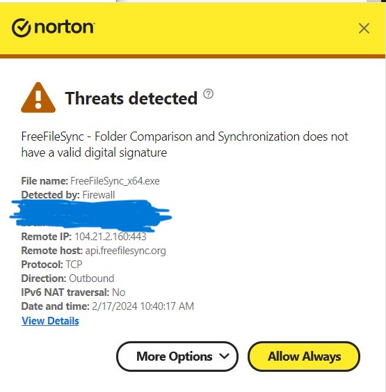

Windows 10pro Norton is reporting the digital certificate is not valid. I downloaded the file this morning and was just now going thru the install.
Is there an issue or is it relative to Norton Security?

this is the error message. Folder Comparison and Synchronization does not have a Valid Digital Signature.
Also, this is the second version just downloaded and install attempted.

I looked at that document. Here's my concern. I re-installed version the previous version and there is no issue with the digital certificate. It is only this specific version that has the issue. To me that's not normal.

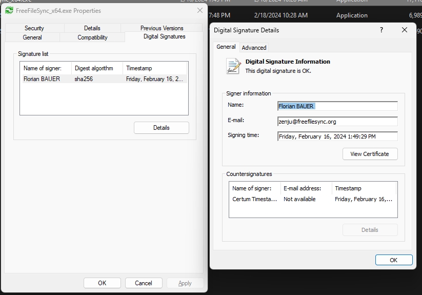

Ok - The information I needed was the certificate data as you presented. Your signature time stamp is different than mine. Mine shows Friday, February 16, 2024 1:54:53 PM. Is not a certificate's time stamp what determines the legitimacy of the certificate? My experience with Certificates which is near a decade ago is that the time stamp was critical is that no longer true?

This BS happens after every new release. It's called "reputation based heuristic": https://freefilesync.org/faq.php#virus
Different exes obviously have different certificate timestamps.
