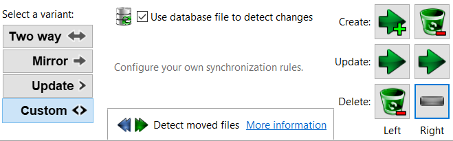

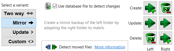

However: I checked the Action icons for a Mirror sync (when using the database) And it seems xCSxXenon is right. The bottom right icon (Copy new item to the right) suggests that the target-side deleted file will (still) get recopied source=>target. So, there does not seem to be a clear difference for a Mirror sync between using the database or not (apart from being able to detect moved or renamed files).
I then looked at an Update sync, but that does not seem to meet the needs of the TS.
Then I looked at a Custom sync By setting the Actions identical to the Mirror sync, except for the bottom right one (which was changed from "Copy new item to the right" into "Do nothing") it seems the objective of TS can be achieved: files that were deleted at the (right) target side will not get recopied source=>target.
The only thing I am not sure about is: is this consistent over multiple syncs?
That is: does the database still know a target-side file existed but was deleted; not just the first sync after it was deleted, but also during any consecutive sync?
