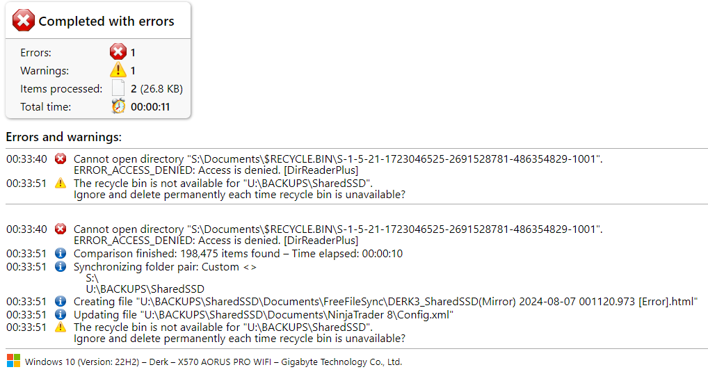

I keep getting error reports regarding recycle bin, like this:
Anyone know how to fix these?
Recycle bin not available

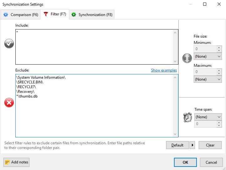

It is not clear to me how this helps. I have recycle bin excluded in the sync; probably should have included this in original post:
I had noticed previously that my attempts to exclude it did not seem to work as expected.
Change deletions to be permanent in the "Synchronization" settings tab

I gave that a try. Saved it as batch file (which I use with real-time sync), but it gave me the same errors.Change deletions to be permanent in the "Synchronization" settings tab xCSxXenon, 07 Aug 2024, 21:02

Maybe it's a recycle bin issue. When I look at the one on that drive, it just has a bunch of Read-only, hidden folders:
Might be worth "resetting" the Recycle Bin folders on those drives

Tried "resetting"; eventually I was able to delete it from S: (which is just a mapping to physical drive E:). And then when I run the sync, I get the same error, despite the fact that no longer has a recycle bin. Not sure what to do about that. Seems like my only option is "Ignore Errors".
