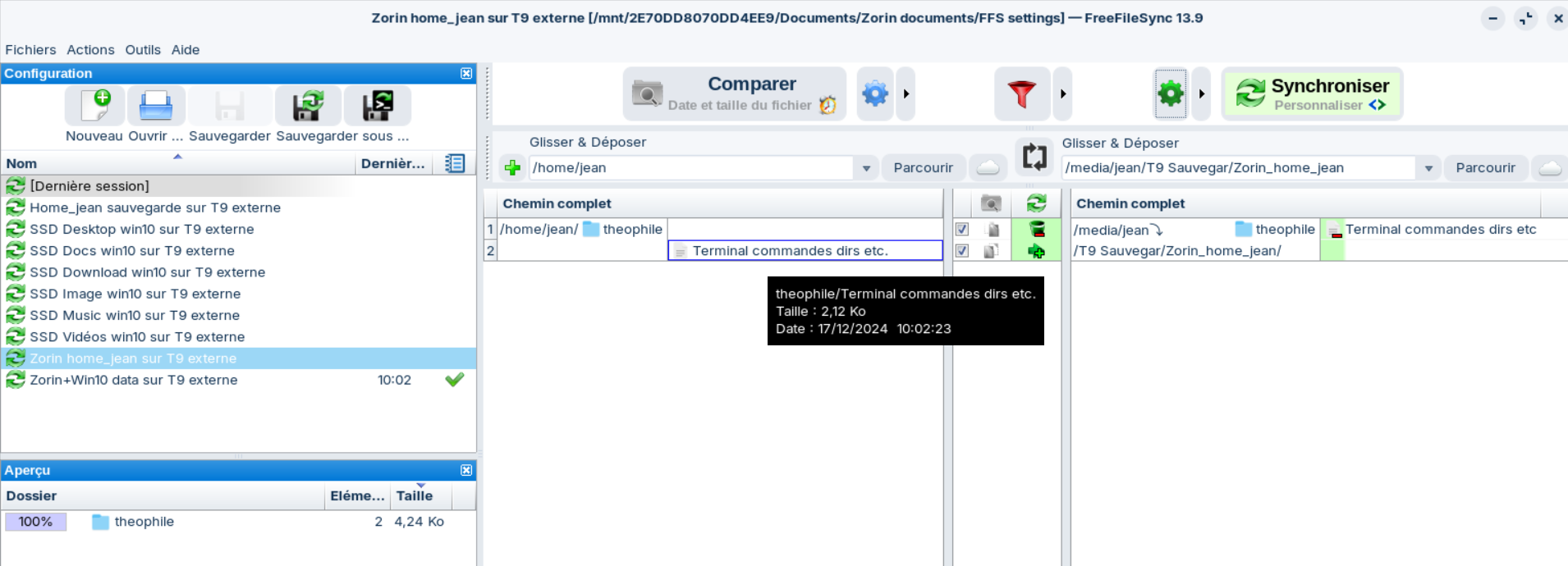

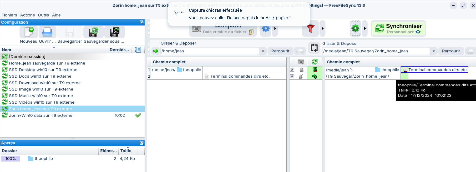

Hi everybody,
I am now exclusively running FFS for my backups and am very happy with it. When I have a large change I always check a few things before running Synchronization and, I don't know why, in such case I rerun it again after the synch to ensure the left and right columns are empty. This time when rerunning it I found a strange case for which I would be glad to get some answer. I mean the left and right columns were NOT empty. 1 file was displayed. And it was shown as requiring 2 actions, 1 addition from the left column, and 1 deletion from the right column. I send you attached 2 screenshots of the 2 columns, one showing details of the left file, the second details from the right file. Both show same details. Should'nt they be in the = box ? And when I repeat the comparison after having run the synch, I get them appearing again.

Looks like the "." after "etc" went missing without error indication, thous the endless cycle.
- Posts: 5
- Joined: 10 Oct 2024
Hi, thanks for your blitz answer Zenju. Actually I was about to say the dot might be the problem. Because the right column is ntfs, the dot is suppressed, hence when comparison is rerun the files are different. I suppressed the dot in the file on the left columns file and reran compare... and all was empty back to normal...
