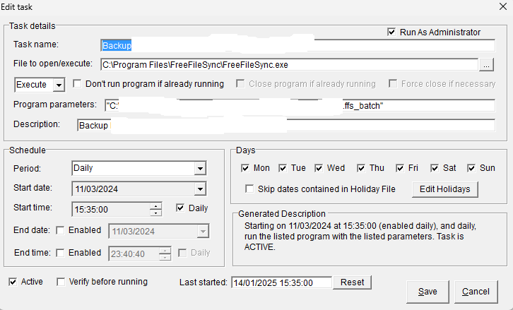

Just to say, exist a not intrusive and complete FREE utility to bypass most/all problems that u can encounter with the programming in "Task Manager" in Windows system. The utility is called "Solway's Task scheduler" and have all configurations You've need without complicated settings, I use it in Windows 7/10/11 from many years, and work fine, and it have more useful fastest options to enable/disable Your task and to work with/without high privileges... and more. Don't have any annoyng popups or ads!
Please note this utility use ONLY English language!
If You want try this utility : https://theabsolute.net/sware/#tasksched

Totally unnecessary, those are the exact same options available in Task Scheduler anyway.
Choosing Basic Task has no effect other than setting some default settings that likely won't matter for FFS
