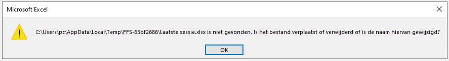

I suddenly ran and keep running into an error when I try to export a file list in FFS/Excel which I have done so many times and I use it a lot.
The error that I encounter is quite persistent, I have reinstalled FFS and Office365 but to no success, the error keeps coming (attachment).
How can this error be solved?
in Dutch, it says: 'file' not found, is it moved or deleted or name change?
error export file list.JPG (17.65 KiB) Viewed 17523 times

Does that "temp" directory actually exist if you try to browse for it in File Explorer?
Open File Explorer and enter "%TEMP%" into the address bar on top

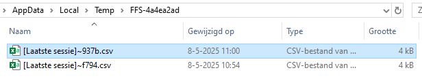

The folder that is mentioned in the error also exist and contains csv files that obviously are created when trying to export a file list (attachment). When I try to open a csv file with Excel the same error occurs ("file not found, moved or deleted etc").

You could try moving/renaming the files and trying to open them again. This would be testing if there is an issue with the path or name, for some reason.

By renaming the generated csv file in the temp folder I was able to open it in Excel. The file contains a regular file list, I can't see anything wrong with it.

It looks like Excel is trying to open, "Laatste sessie.xlsx" - an .xlsx file,
rather then an 'Export file list', .csv file.
You do have .csv files in that (now named differently, cause you've restarted FFS) directory, but not .xlsx (at least from what is shown).
You do have .csv files in that (now named differently, cause you've restarted FFS) directory, but not .xlsx (at least from what is shown). therube, 08 May 2025, 15:32
Good catch! OP, are you using the latest version of FFS? Mine exports as a csv and opens fine in Excel. It seems weird that it would export a csv file and then try to open an xlsx file with a completely different name.

When I place an empty "Laatste sessie.xslx" in the temp folder, Excel opens this empty file after generating a file list export in FFS, without an error. A csv file is also placed in the temp folder but is not opened.

Just verified. For me exactly the same problem (Win10, Excel365)
The problem is that although the file is written as a *.csv-file, Excel tries to open (it as) an *.xslx-file, which is not there.
Even double-clicking the *.csv file FFS created generates the same problem.
However, if from within Excel you select to Open a file, then Browse to all files (*.*) or Text files (*.prn,*.txt,*.csv) and then select the csv-file FFS created, it open without a problem.
So, it is clearly an Excel problem!

Apparently an Excel bug when the file name contains brackets: https://www.reddit.com/r/excel/comments/1k7qmrx/brackets_are_breaking_filenames/
Posts: 2995
In Office version 2509 (perhaps already from 2505 onwards) the problem seems to have been solved.
A file named [Test] Book.csv now opened just fine by double clicking.
However, if from Excel you try to save a file as [Test] Book.csv it fails:
So, instead of really solving the problem, Microsoft now simply also disallows the use of brackets when saving a file ... .
This in conflict with their own list of reserved characters.
Remarkable is also that the use of brackets is no longer allowed when saving from Excel, but still works fine when saving from Word (did not test other apps that are part of the Office suit) .
