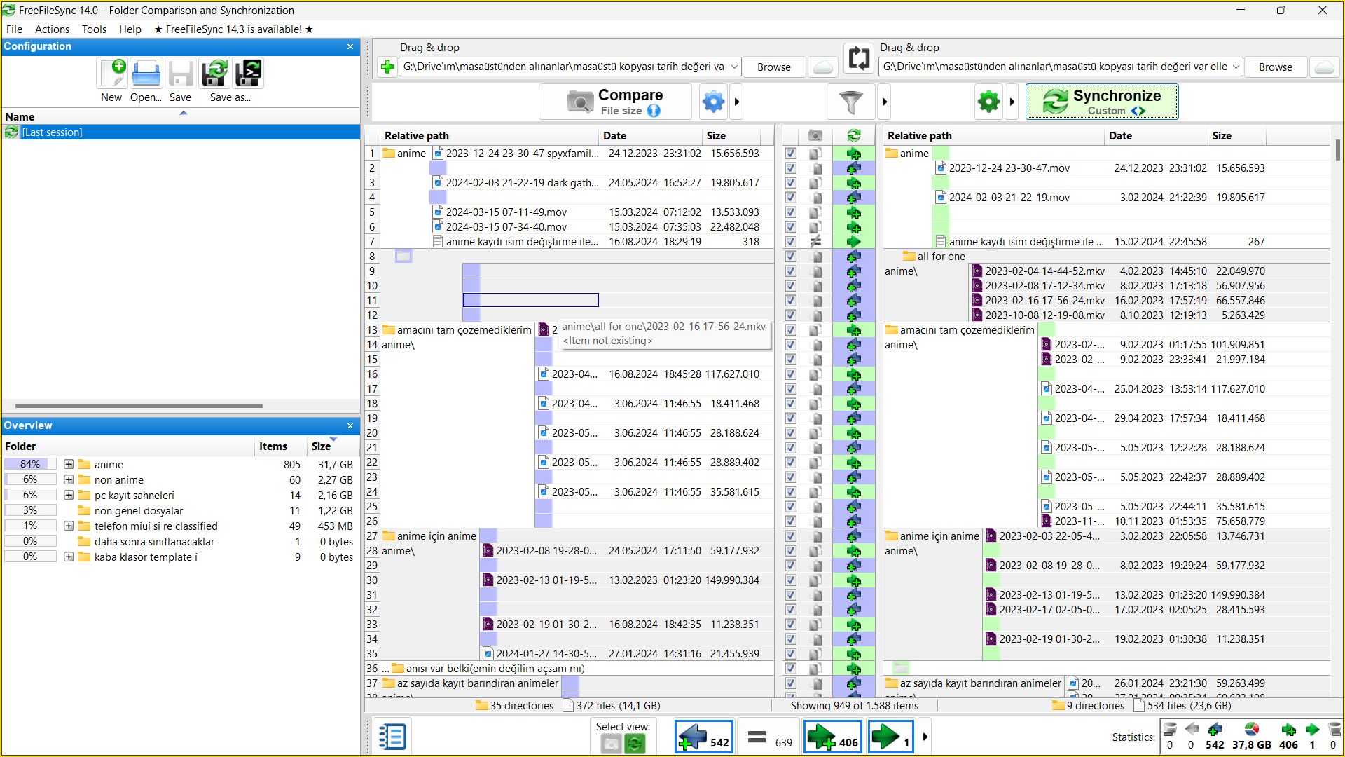

how it works: basically it ignores the name of the files and simply compares sizes to assume if theyre same or not , so if there was 3 same sized file in same file itd assume its the same file (if they arent we can manually change it which would greatly decrease the work load compared to checking every single file)
why i think its useful/necessary in my use case : it shows all my files as a different file just because i changed the name order(i added tags to file names so that i can search them easier) and im trying to check if i accidently erased anything and recover it from the old backup
Feature request:Ignore file names

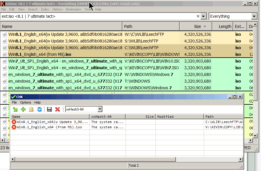

(Aside from a duplicate file finder...)
For finding files, there is nothing better then Everything.
(Everything 1.5 alpha is even better.)
Once found, you can send them to a place like a file hasher.
(Pictured files are all offline, so no actual hashes were generated. Otherwise, it would, & they would compare - hopefully.)
Everything, https://www.voidtools.com/forum/viewtopic.php?t=9787
CHK, http://compressme.net/ (or whatever hasher you prefer)
[img]C:\out\Everything - finding files same size diff name.png[/img]

i would like to add a sidenote that driver g is google drive and theyre not downloaded on my pc , so to see their hashes or etc , id need to download tens of gigabytes to my laptop(which i dont have or wont worth to create in this case)
