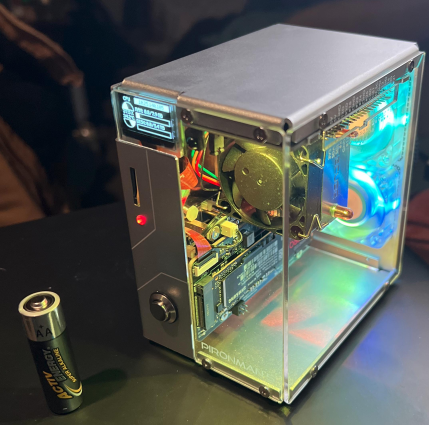

Understood. Sry, I'm trying to run from a Raspberry Pi 5 (ARM arch); it is my Plex server.
