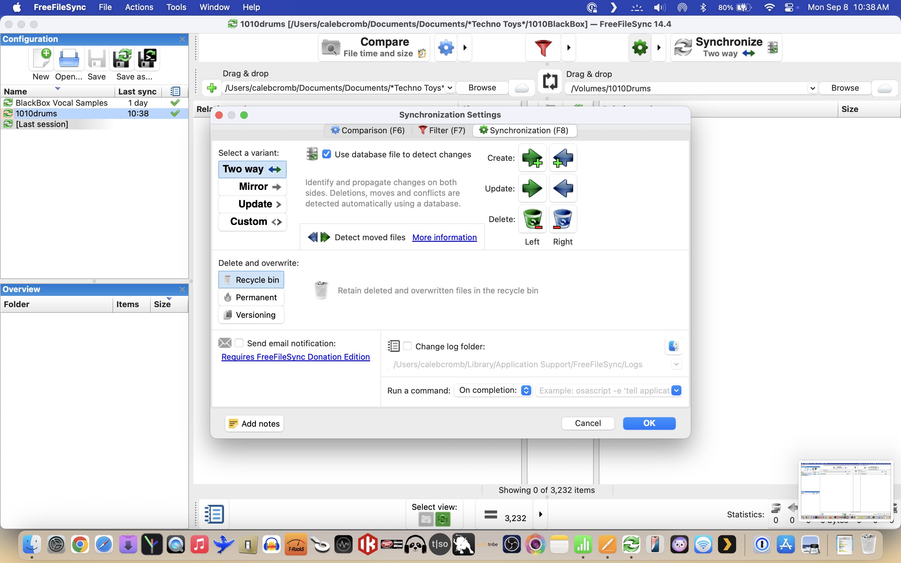

Have it set up with "Use database file to detect changes" check box checked and beside 'Create' is the green arrow going right and the blue arrow going left.

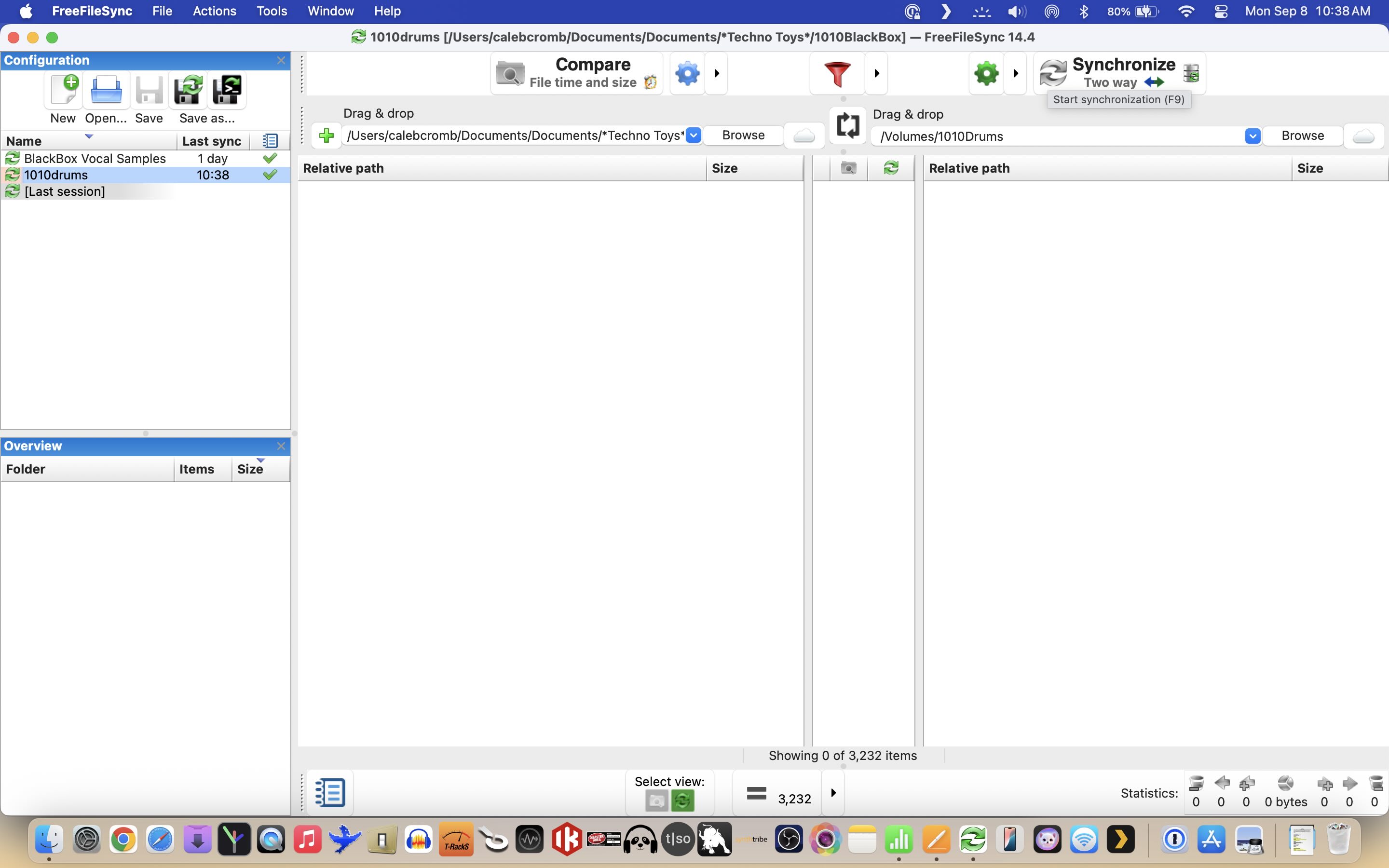

Run a comparison, and then attach a screenshot of the entire FFS window once the results show up.
Are you actually using the "Two-Way" sync method?

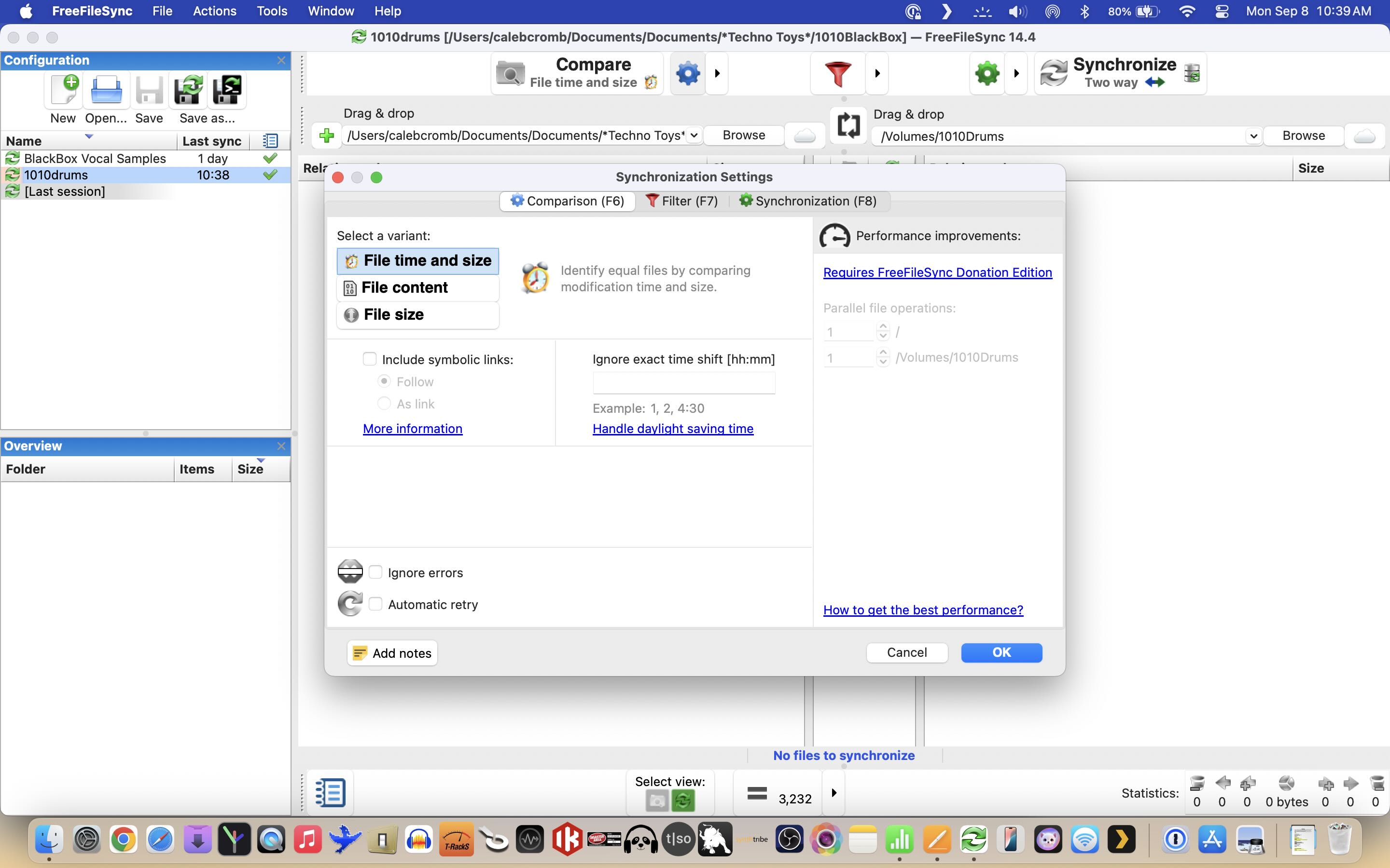

Hopefully these screen shots are what you were looking for?
Thanks for helping me with the attachments.....can't believe i didn't see that lol
- Posts: 3019
The picture(s) you are sharing show that no sync actions are required, and all 3232 files within scope for syncing are actually in sync. (Click the "= 3,232" button mid below the left and right Compare results to view all 3232 files.)

- Posts: 4941
I'm betting you made a typo. The location on the left looks to be set to "1010BlackBox" but the right side and name of the config are using "1010Drums". You are probably working and making changes in
".../Documents/*Techno Toys*/1010Drums"
but that isn't the folder you have entered in the left side.
