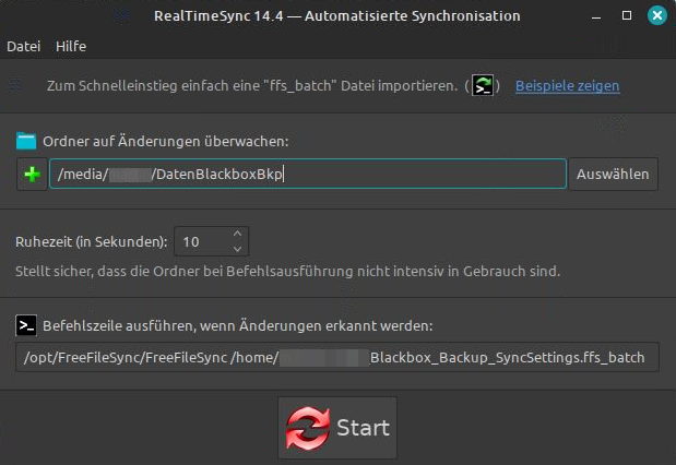

Can you post a screenshot of the RTS configuration window?

- Posts: 5
- Joined: 11 Sep 2025
Wouldn't RTS fail for the lost+found of the source-disk then also? (which is interesting, that it complains about the target first)- Have RTS look for a subdirectory on the external, instead of the drive itself.

- Posts: 4933
Since you configured RTS to monitor only the external location, the lost+found directory on the source poses no issue. I'm guessing "DatenBlackboxBkp" is the mount point of the external. Move the data into a subfolder, name it whatever you want, and have RTS monitor that instead.
