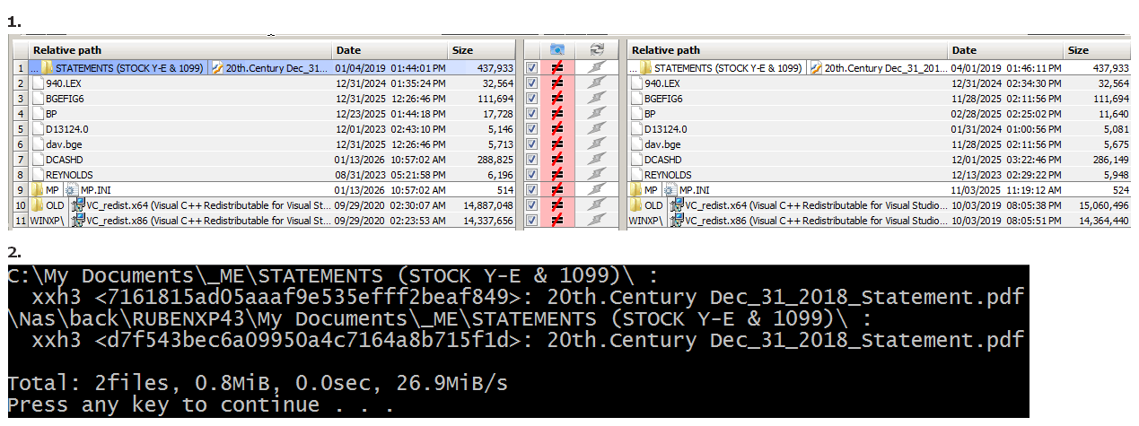

So I ran a scan, Content compare (which I don't typically do), ~40 GB of data (so smaller then your dataset).
20th Century. Same size, day/month .happen. to be reversed, target being newer then "source".
That's a bit odd?
And I would of, kind of, expected my regular Date/Time compare (with an Update sync) to have at least pointed that out (but it does not - maybe that's "normal"?).
940.LEX. Again target is newer, by ~1 hour, so maybe DST is playing in? That the size is the same is not unexpected. The files are not the same, though unsure what the differences are (& again I was unaware of this).
BGEFIG6, source is newer, so my normal Time/Size compare will update the target.
D13124.0, is odd (to me), target newer, but smaller.
REYNOLDS, ditto.
So with my brief exploration, not really seeing anything amiss - at least not on the actual Content compare end.
That's a bit odd?
REYNOLDS, ditto.
