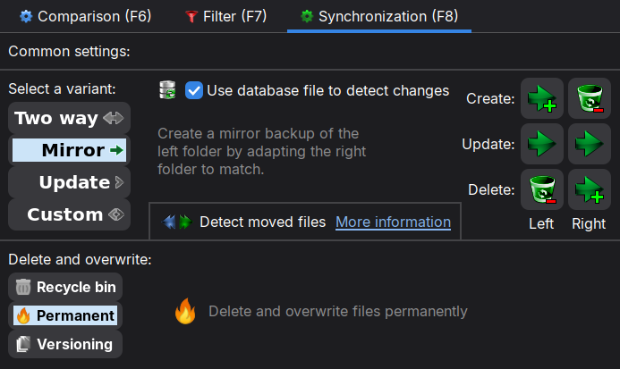

Did you check "Use database file"? And if you check it, it takes at least one full normal sync before it will detect changes properly in order to move the files (instead of deleting them and copying them again). It should look something like this if you want to mirror/backup left to right:
Screenshot From 2026-02-04 16-17-02.png (65.61 KiB) Viewed 161 times
Usually you can sync any folder to any folder with FFS, doesn't matter if it's the root of a drive or any subfolder.
For scheduling (autosync) you can use the "Windows Task Scheduler". There are plenty of tutorials on how to use it (I don't use windows, so I barely remember). The selected Program would be something like this:
"C:\Program Files\FreeFileSync\FreeFileSync.exe"
and arguments:
"C:\path\to\your\config_file.ffs_batch"
If you're on linux, things are obviously different.
