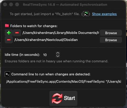

Hi there,
I’m trying to set up Real Time Sync to automatically start when I log in on my Mac but it doesn’t seem to work unless I manually start it. I’ve tried adding it to “Open At Login” in settings but it doesn’t seem to activate.
Is there a way to automatically start it?
Once started it works like a dream.

Hi, thanks for the reply
I have already set up automator scripts to run backups at night. They have been tested and working fine.
What I am after is real time sync, so if a folder changes 10 seconds after a sync job happens.
The companion program RealTimeSync does this, but I have to start the program and press start every time I reboot my Mac. I am asking is there a way to start that program automatically?
I have attached a screenshot of the program in question.
Kira

I literally already answered your question in my above reply
don't drag/drop your *.ffs_batch FFS sync configuration file, but instead drag/drop your *.ffs_real RTS configuration file.
