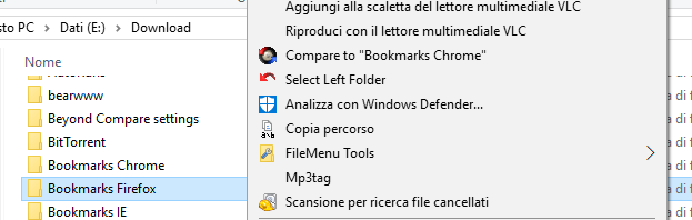

- Posts: 333
- Joined: 13 Apr 2017
Beyond Compare handle it in this way.
Classic, you have selected the two folder you want compare, click "Compare":
You have selected the folder you want on the Left side, click "Select Left Folder for Compare":
You have selected the folder you want on the Right side, click "Compare to "Bookmark Chrome"":
Only at this time "Beyond Compare" launch with the two folders loaded.
