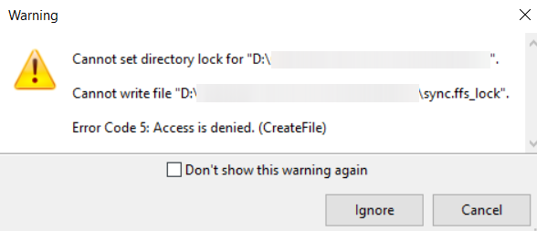

I am using the current version of FreeFileSync V8.1 April 21 2016.
I have created a sync job using the update sync method of about 14 left & right pairs, where the target is another physical drive on my Windows 10 Home (32 bit) pc. If I use Compare & sync it works well for a few times. Then I created a batch job from there and opened it in RealTimeSync just to get the command line arguments to use in Windows Task Scheduler, where I just created a basic task to run a program daily & used the two halves on the command line section of RealTimeSync to enter the first half as the program to run & the second in the arguments box.
If I run this a few times all is fine. Then another run either from the batch job or the FreeFileSync GUI, I start to get the error
“Cannot set directory lock for <target folder>”
“Cannot write file <target folder>\sync.ffs_lock”
“Error code 5: Access is denied. (Create File)”
I have attached a screenshot of this.
Please can someone tell me what I am doing wrong?
