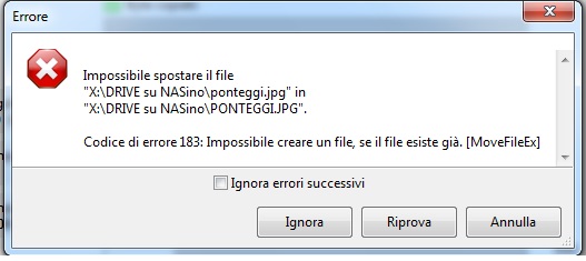

I have a pen drive on my router, so it is on lan. On this pen drive I have some files that I syncronized with the master files in my pc.
Well, some files (copied by FreeFileSink) are been copied in lowercase characters on this pen drive from my pc.
Every time I try to syncronize them, a lot of files must to be copied because only the name are different : in the pc are in uppercase while on pen drive are in lowercase.
This is only a part of the problem, in fact FreeFileSink is unable to copy them, it generates an error and I must Ignorate all error to finish the task.
There is a solution for that?
I attach two pictures to let you see.
Many thanks
Files are copied with the name in lowercase

Does renaming the files on the pen drive work if you do it manually via Windows Explorer?

So and so...I make an example for you
I have this file : dscn1103.jpg....If I try to rename it with tha same letter but in uppercase like this DSCN1103.jpg an error returns " the file or the folder not exist"
Instead if I try to rename wit another name like : DSCN1109.jpg... yes this time I can rename....it is very strange

So the error messages are gone? But the target file name case did not change from lower to upper case as it is expected? Is there really a problem with FFS creating the files in the wrong case, or were these differences already there before FreeFileSync? Notice that the error message is not about copying files but about moving them (i.e. changing the file name).

The error message is no longer at the end of the sync, but at the next check they are all to be copied again. In fact FFS tries to move the files to lowercase to replace them with uppercase.

That's weird. The latest FFS beta basically does exactly what you did manually before: rename the target to some temporary name, then rename to the actual target name to avoid the bogus "already exists" error. Can you simplify your test case via an include filter so that it only tries to rename a single file and send me a Process Monitor trace as well as report the actual result as shown by Explorer?No, the last relase complete the sync without error windows, but the names of original files that are in uppercase, stay in lowercase, into destination folder.apatrik, 26 Apr 2017, 20:12
