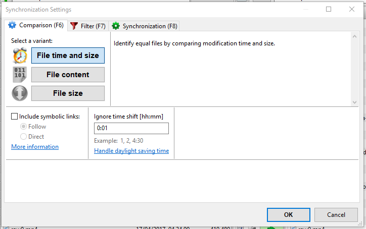

Putting values in "Ignore time shift [hh:mm]" in the "Synchronization Settings / Comparison" panel is totally ignored.

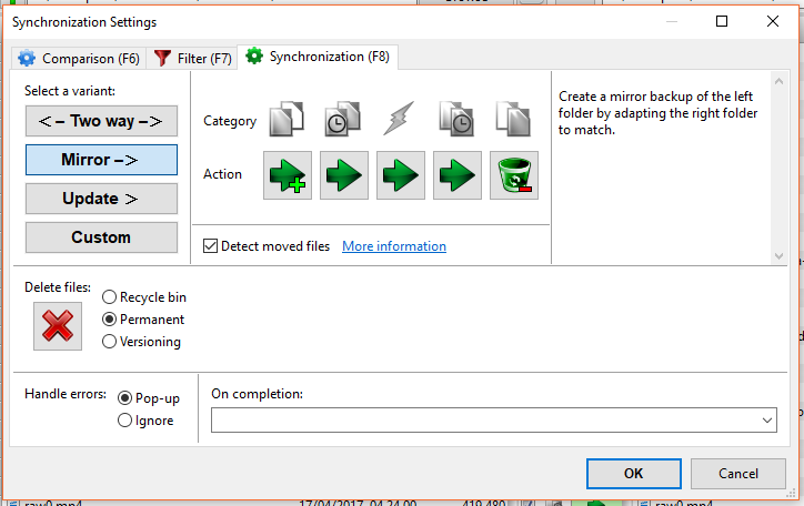

only one "Folder pair", Mirror, compare by "file time and size", "Ignore time shift" 0:01
Screenshots follows.

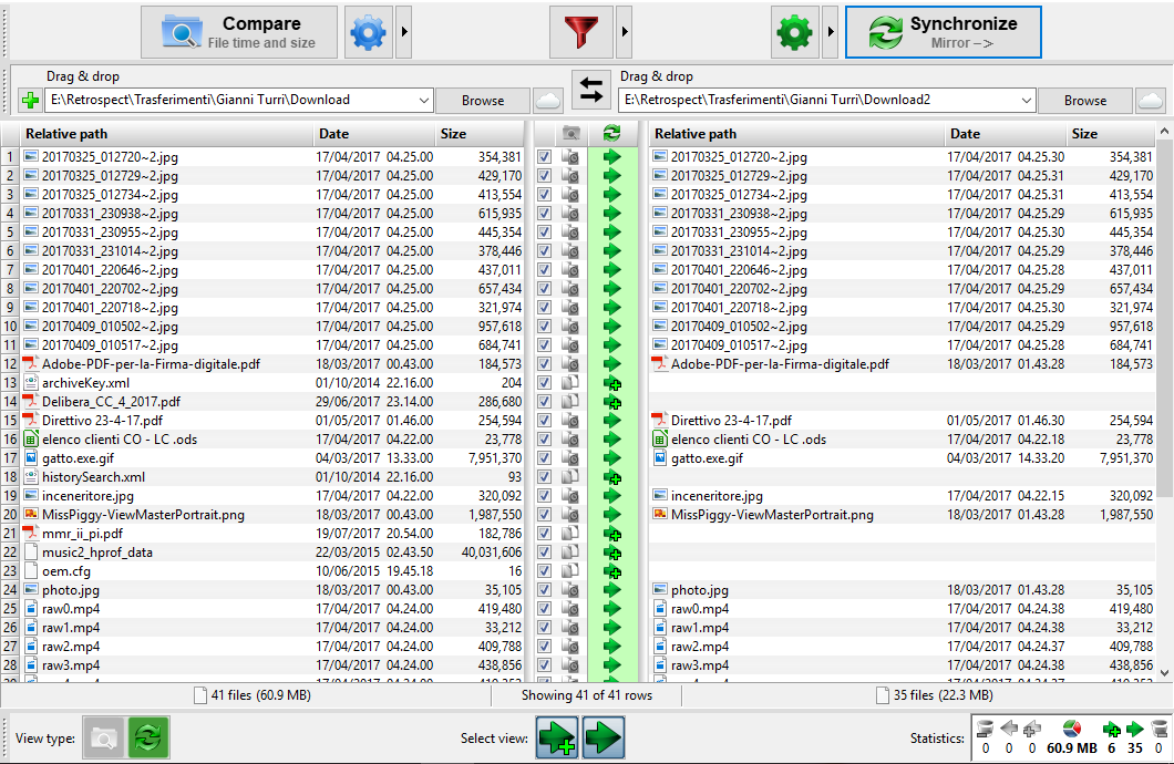

File list:
Comparison:
Synchronisation:
BUG: Ignore time shift is ignored

It's a time *shift* not a tolerance: https://freefilesync.org/manual.php?topic=daylight-saving-time
- Posts: 333
- Joined: 13 Apr 2017
Thanks Zenju, sorry, yesterday for some reason I heaven't seen the Note ...
No way to implement also a Tolerance?
FFS uses a 2 seconds tolerance, but I wouldn't know of a reason why to change this: https://freefilesync.org/manual.php?topic=expert-settings
