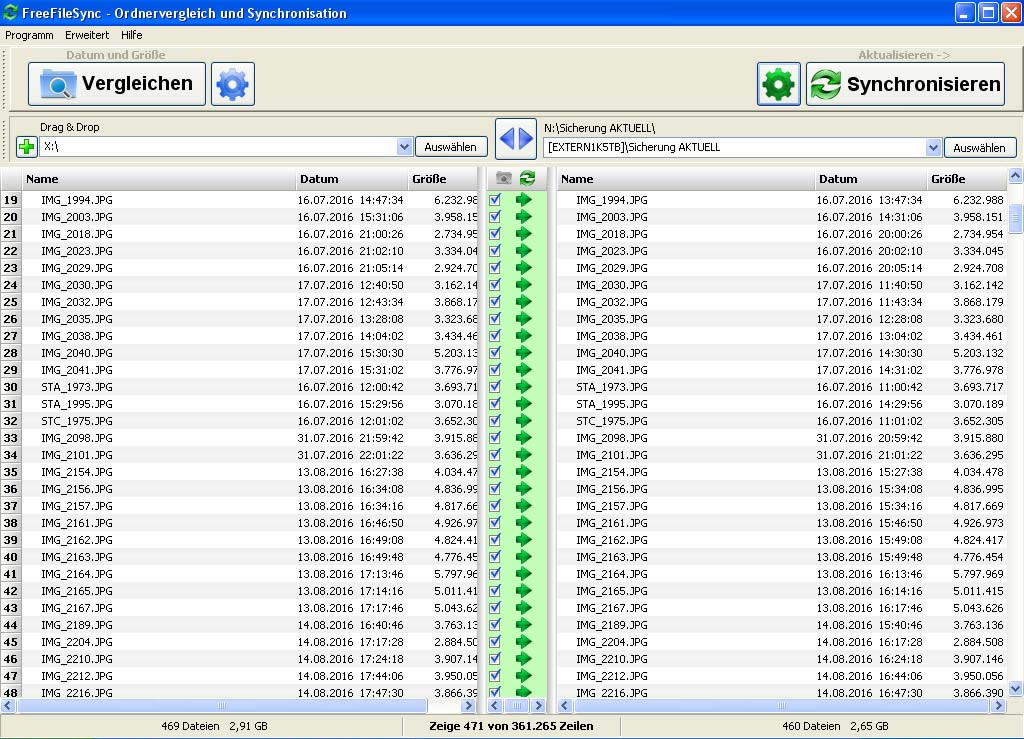

my father uses freefilysync to transfer his data/pictures to an external device.
the problem is that many pictures are synced every time. Seems that there is a problem with the timesync between the files. see annex

I don't know what the problem is but do notice that the time difference of the files is exactly one hour for all instances on view. And that suggests to me that FFS is operating as it should be. It would also suggest to me that some other part of your father's system has gone and adjusted the time-stamp on all those files by exactly one hour - I have no idea what could be doing this. If that is what is happening then when you post you would need to state what operating system your father is using - that information might help people track down the problem for you.

Hello dsca!
Can it be that this problem has occurred after 29/10/2017?
My guess is that it's not a problem of FreeFileSync, but results from the time change after the end of daylight saving time.
If I'm not mistaken, the effect occurs between NTFS- and other file systems because the file time is stored differently.
I have this effect when I synchronize (mirror) my files from the NAS to my Android devices right after the daylight saving time (not with FFS).
Under "Actions" -> "Comparison Settings" you can enter 01:00 for 1 hour in the field "Ignore time shift [hh:mm]" (becomes 1).
I did not try it myself, but maybe it would be worth a try.

Yes, Bingwu, I think you have the correct explanation. There is a page in the FFS Manual for this issue: Daylight Saving Time (Windows)
It would be great if dsca could experiment with this and report back what he finds. It's an interesting problem.
