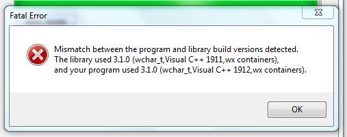

Sorry, but I was unable to install this beta due to a library error of some sort:
"Mismatch between the program and library build versions detected..... (etc)"
(Please see the attachment.)
I guess that means my Visual C++ library needs updating?

Sorry my bad: http://www.mediafire.com/file/1rxgszpb3zu8344/FreeFileSync_9.6_%5BBeta%5D_Windows_Setup.exe"Mismatch between the program and library build versions detected..... (etc)" rogerval, 06 Dec 2017, 19:44
