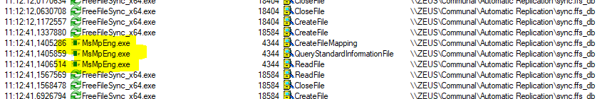

My bet is that some other application is holding a handle open to this file. Most-likely culprit: misbehaving AV software. To verify this theory you can use a tool like Process Monitor: https://freefilesync.org/faq.php#trace

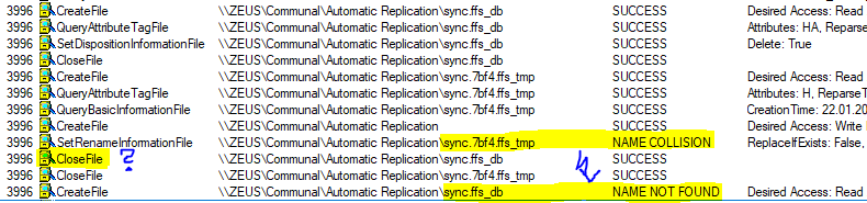

I have just sent you a ZIP file from Process Monitor as it makes very little sense to me.

To my untrained eye, the second looks like a race condition.

I followed your instructions regarding disabling the AV programs. Three of the laptops run Windows Defender and the other runs Avast Free. All have been modified to ignore the shared folder on the Server (ZEUS). After this change, I rebooted the server and all laptops. No change to the errant behaviour was observed.

I now often run Process Monitor to try and see what is happening but the output is huge - the errors may take a minute or two to appear. I have run a few with a filter set to the shared folder on the Server and that limits the output significantly. Would these filtered logs be helpful to you. If so, and/or if you would like other filters set, just let me know.

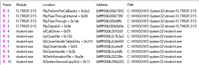

Can you create a new Process Monitor trace up to the point where writing the sync.ffs_db file fails?

In Logfile04.pml I see a hint about the following error:
There's the NAME_COLLISION (error 183), shortly followed by NAME_NOT_FOUND, both for "sync.ffs_db" which looks like a contradiction. However it can be explained by the spurious "CloseFile" in the middle: The "sync.ffs_db" deletion should already have completed above after the "CloseFile" following "SetDispositionInformationFile", but obviously it has not, so the file is still not physically deleted. Why? The call stack for the spurious "CloseFile" seems to originate from somewhere within the OS, not the FreeFileSync process. Also I do not see a corresponding "CreateFile". Network driver issue?
As for the remaining file access errors I suggest the following approach:
First simplify your test case to only include two PCs into your setup.
Then add PCs until the first "Error Code 5: Access is denied" occurs.
Run Process Monitor on the PC added last that triggered the error.
Hopefully the log will show which processes on this PC are responsible.
[10:55:55] Error: Cannot move file
"\\ZEUS\Communal\Automatic Replication\sync.7bf4.ffs_tmp" to
"\\ZEUS\Communal\Automatic Replication\sync.ffs_db".
Error Code 183: Cannot create a file when that file already exists. [MoveFileEx]
