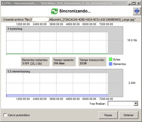

I have reviewed the SD Memory permissions and increased the "access timeout" in my ftp configuration to 60 seconds (it was in 15 seconds) and it seems that it is synchronizing the 25 GB between 1 and 4 days, it is changing. In 24 minutes, 0.42% was synchronized. The speed varies between 0 and 300 kB / sec, although most of the time is in 0 bytes / sec. How about?

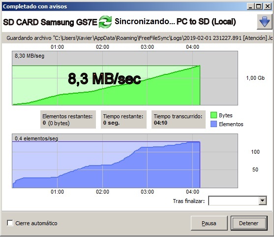

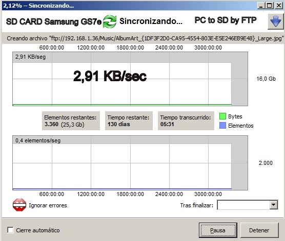

I used the same Samsung GS7 SD card to synchronize the music folder in the following two tests:
First, with the SD card installed in my Samsung GS7, I synchronized the music folder through FTP, producing a slow transfer at a speed of 2.91 KB/s, making synchronization impossible. Then I connected the SD locally to my computer, transferring quickly to a speed of 8.3 MB/s with a good synchronization. Apparently the speeds differ greatly from one case to another.
If possible, I would appreciate your help to continue solving this problem.
PD: The two synchronization options are shown in the figures of the attached user interfaces.

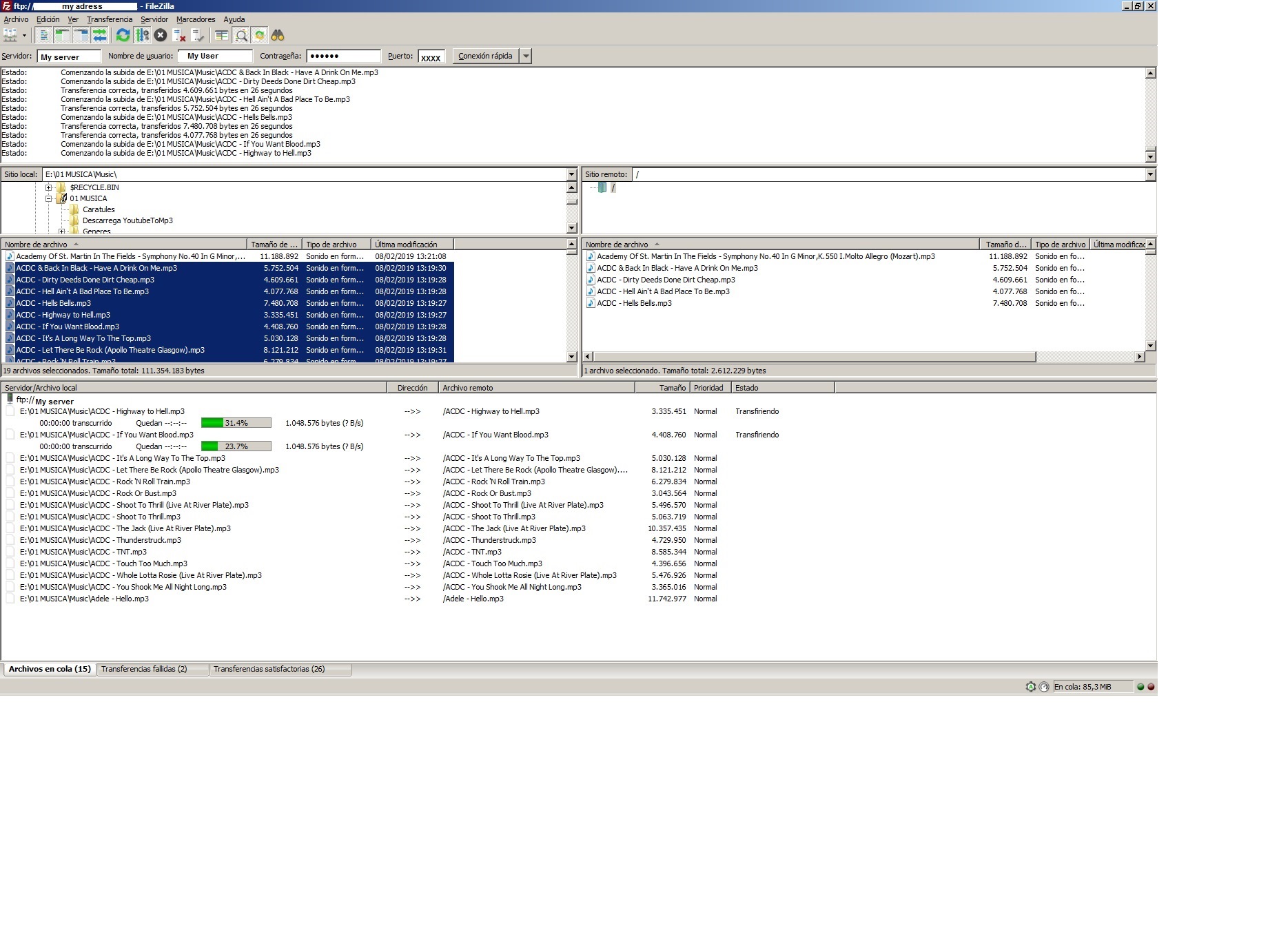

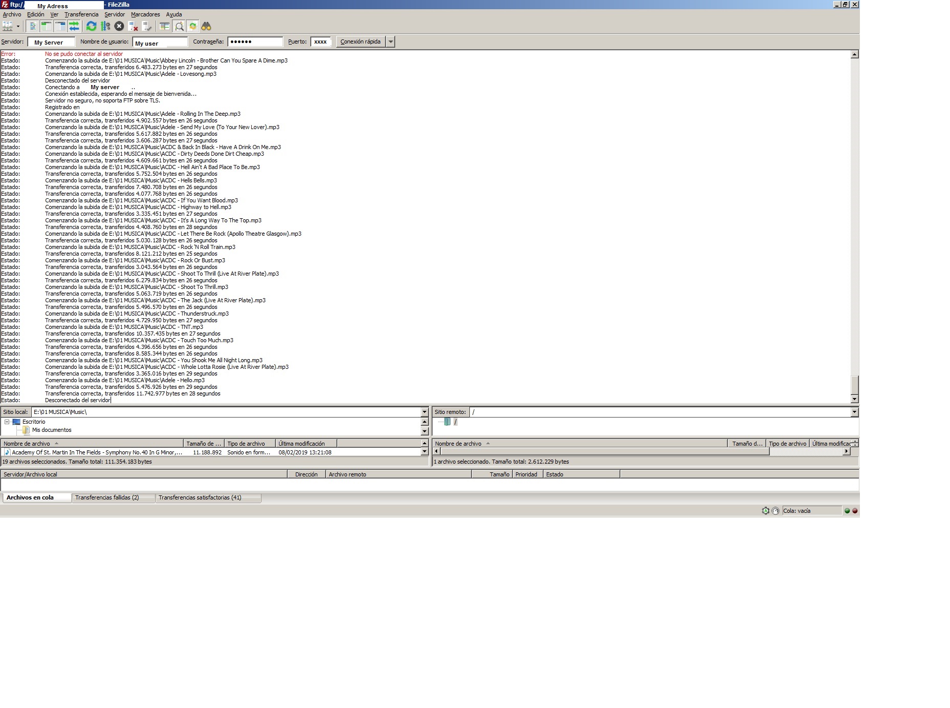

- Posts: 11
- Joined: 24 Jan 2019
As you told me, to determine if it's a problem with FFS, I tried to sync the files to the phone - and also on the tablet - using the FTP client FileZilla on PC and the FTP server "Servidor FTP Pro" on the phone and tablet, set it up as when using the FFS (with a timeout of 60 sec on FTP client).
Although the sync is not as fast as with the internal memory, I have performed the sync in a fluid way and I have not had the same speed problems as with the FFS. No file crashed, so there were no specific files or file types that caused problems except for some retries.
So could it be that the problem is about the way ftp is configured in the FFS?
As always, thank you very much for your interest.
