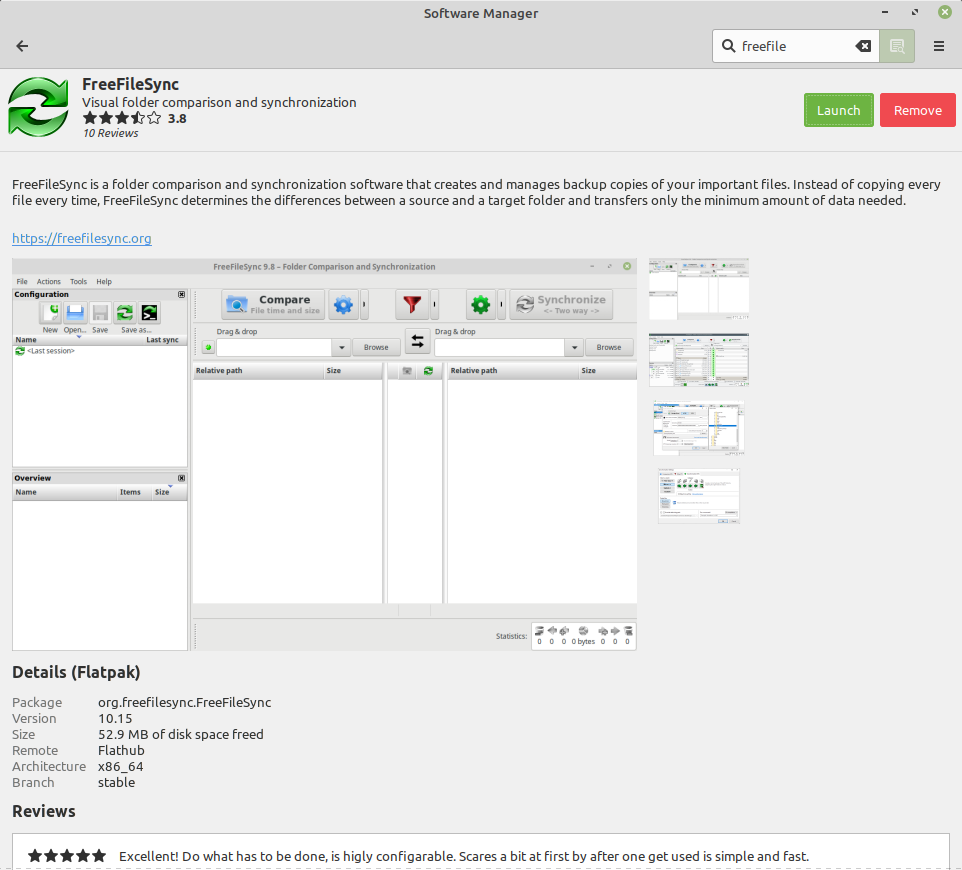

The RTS command line runs the Program FreeFileSync and passes the parameters of the fff_batch file to be run.
I have a batch that syncs the Linux "documents" with a uSD that contains the Laptop "documents" and a HDD that contains the Windows "documents" such that when I insert the uSD off it goes. Or thats the idea.
With no knowledge of where stuff is I decided to find the program that is run when you click on FreeFileSync and since I installed FFS via the Software Manager I have no idea where it went. It is NOT where RTS thinks it is when you import the ffs_batch so a little hunting.... For reference RTS thinks FFS is in "/app/FreeFileSync/FreeFileSync" since thats what it auto-builds when you import the ffs_batch. There is no /app directory in the root or home/username directories.
It does seem that FFS is installed using Flatpak and the run command for the desktop icon goes to /usr/bin/flatpak and runs a command there so it may be the reason RTS will not execute correctly. Its running through flatpak.....
Any ideas?

Hunting the FFS prog leads me closer with
/var/lib/flatpak/app/org.freefilesync.FreeFileSync/x86_64/stable
Its the only thing in /flatpak/app
Ah, so you're not using the official Linux build from freefilesync.org, right? So these support questions should go to whoever is maintaining your flatpak package.What path does the FFS installation routine for Linux Mint install in? This is the real question I think as the ffs_batch is easily located. The installation is what is hidden..... Trevor, 01 Oct 2019, 19:06

I have no idea. I am using the build in the Linux Mint Software Manager which I kind of thought would be the official approved version....
