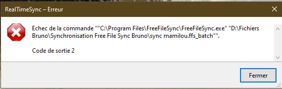

Realtimesync return back a message "Error Code 2" After syncronization, when a file is used by another process ( like "Outlook.pst" when user open outlook).
In Freefilesync i took ignore errors, but it's realtimesync who return a message.
I hadn't found any option to ignore error in realtimesync .
I have the problem only since last update !
I need Your Help ^^ Plz ! V10.23

I am getting the same error message from RealTimeSync
I get the error message the first time RealTimeSync runs. After I click the close button the sync appears to work correctly.
I got this error message when I updated to V10.23

Same to me.
My FFSync.batch works fine.
Starting it by RTS brings the above shown message. Only in German. ;-)
The problem starts with the current version V10.23 (Donator)
V10.22 (Donator) works fine.
