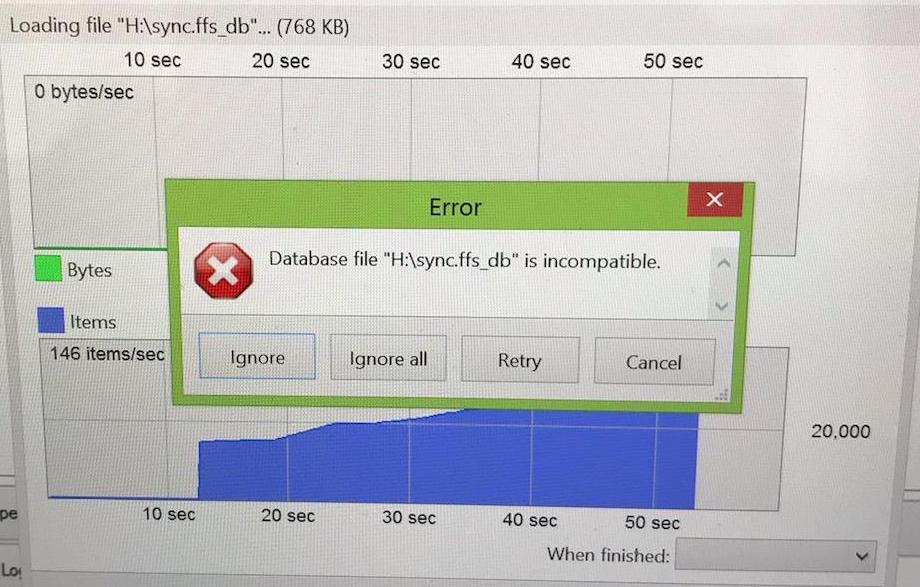

We use FFS to keep a large folder synchronized two-way between about 7 laptops and a central samba server. This has generally worked well. However within the past few days, someone will try to sync and get a warning that the sync.ffs_db is incompatible. The only other time I've seen this was when we had people still on version 9. We're all currently on 10.22 and 10.23. It's very sporadic, so I don't know what is causing it. Today, someone synced, and the sync.ffs_db was a little over 1 meg. Later, someone else synced and got the incompatibility error. We had her ignore it and the new sync.ffs_db file was under 4kb.
We've got a lot of people working from home over iffy hotspots and VPN connections, so I'm thinking it's something due to crappy internet. However there doesn't seem to be any issue with the sync completing (no error messages, at least). It only seems to be a random problem when someone later tries to sync. We've not been able to replicate this problem on-demand.
Does anyone have any suggestions or thoughts on this?
sync.ffs_db incompatible

This is what it looks like when the error appears, for whatever this is worth.
H:\ is our samba server.
- Posts: 7535
I've improved the error message to make it clear what's going on (either data corruption or an old FFS version in the mix): https://www.mediafire.com/file/j83gmoecb55iks5/FreeFileSync_10.24_%5BBeta%5D_Windows_Setup.exe

- Posts: 7535
When the database fails to load and this is ignored, FFS falls back to "copy newer files both ways". This might be the sync direction you want anyway in some cases. In other cases it's wrong. E.g. if a file was deleted it will be copied back or if a newer file was overwritten by an older version, this will also be undone.What's weird is that the syncs that I can personally account for *seem* to complete without error. emptythevoid, 05 May 2020, 23:05

- Posts: 7535
The DB is updated after a folder pair has been synced. Any errors are reported, and saving is done "transactionally" by writing to a temporary file first. So data corruption isn't very likely, unless there is a hardware defect of some kind.When a sync completes, the client writes out the database as a last step, correct? I'm assuming that my users aren't getting an error message during this last step. emptythevoid, 06 May 2020, 11:28
