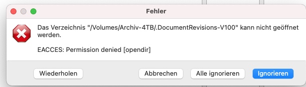

after installing the actual donation-Version 11.6 on my PowerMac OS11.2.1 (BigSur or Catalina before) I get the error massage:
"The directory "/Volumes/Archiv-4TB/.DocumentRevisions-V100" cannot be opened.
EACCES: Permission denied [opendir]"
OSX security settings for full disk access is set to "allow".
Same problem with the normal (non donation) Version.
Thanks for help!
Error message: can't open "DocumentRevisions-V100"-OSX

- Bildschirmfoto 2021-02-17 um 12.02.53.jpg (34.67 KiB) Viewed 6230 times

- Posts: 4911
It's a problem with permissions on Mac, that folder must have been updated to have different permissions

I have solved the problem. Apparently the data structure of the hard disk was damaged. Hard disk utility repair not possible. I reformatted the hard disk and restored the backup. Now everything works again. Thanks for your help xCSxXenon!

Arrgh. The problem occurs again.
But I solved it now (hopefully):
The file: "DocumentRevisions-V100" is not copied by FFS and is excluded by default in the exclude filter:
"*/._**/.DocumentRevisions-V100/"
But either after updating to Big-Sur or to the FFS purchased version (I did both at the same time), this path seems no longer correct.
After I excluded the file in the filter as follows, everything now works without a hitch:
(Without ""*/._** ….“)
I'm just surprised that I'm obviously (almost) the only one with this problem ...
If not I hope this will help.

- Posts: 7523
Indeed the default filter was broken: There was a newline missing between */._* and */.DocumentRevisions-V100/
