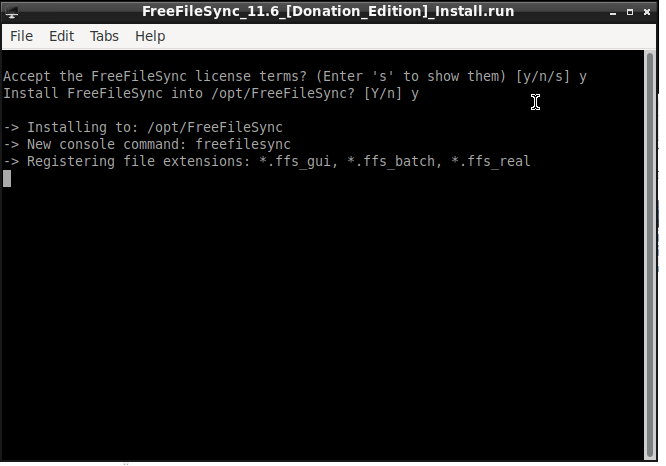

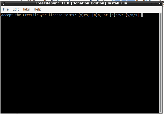

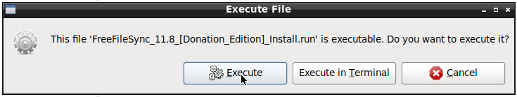

If i run the .run file, nothing happens:
if i press run in Terminal "Accept license terms?" is shown:
after i press "y" --> terminal closes and nothing happens.
with 11.6 the run routine works:
--> but i can not use 11.6 (see discussion in other thread):
viewtopic.php?t=8176
Any tipps how to get 11.8 up and running?

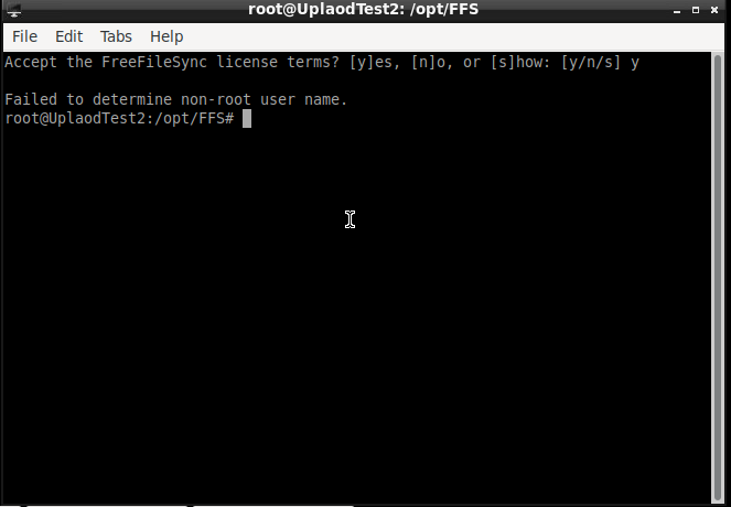

Still exiting after accepting the license? What happens if the installer is started directly from a terminal?
- Posts: 13
- Joined: 28 Feb 2021

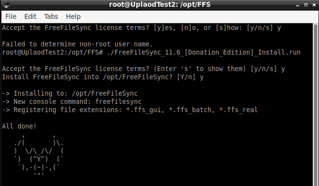

Hi Zenju - it still just exits. So i tried your suggestion - at least there is some failure message: Did you change something in the installation routine? With 11.6 everything works as intended:Still exiting after accepting the license? What happens if the installer is started directly from a terminal? Zenju, 09 Mar 2021, 22:58
Maybe the "non-root" user remark gives some kind of hint. Looking forward to your suggestions.
Tschedrick
- Posts: 7535
Are there any environment variables that identify the non-root user (you can check via "env")? Apparently the ones FFS is checking, $USER, $LOGNAME, all contain "root".
FFS needs the non-root user in order to identify the desktop and create shortcuts.

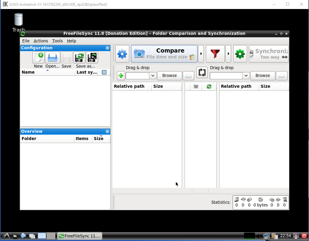

Zenju - thank you very much for your great support! the installation worked with your new options:) but opening FreeFileSync 11.8 still did not work... --> same error message in the terminal about not finding the non root user.It seems you've logged into your desktop session as "root" and this is the only user available?
I've updated the installer to support this scenario. The "Install for all users" option will be fixed to "YES" and "Create desktop shortcuts" is fixed to "NO". This doesn't seem to be a limitation in your case anyway.
You can test this already by downloading the official FFS 11.8 again. Zenju, 14 Mar 2021, 20:01
Your hint with the "only root user" did the trick here though --> I added a user (should have done that anyway...) logged in with the new user --> FFS 11.8 starts as it should :)
Thank you very much!
Good night
Tschedrick
