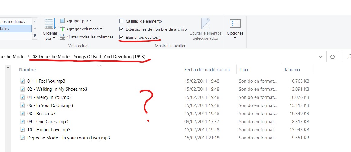

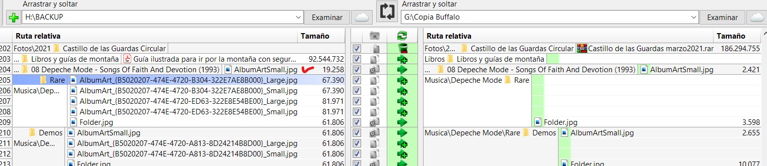

I am using this software to back up my files, but I have a recurrent problem: when I synchronise music files for full albums, I get again all the AlbumArt*.jpg and Folder.jpg files that I want to delete, because I really don't need those when listening to music.
But when comparing these music folders with the backup drive I am copying them to, the *.jpg files are there again, they show on the left panel of FFS!

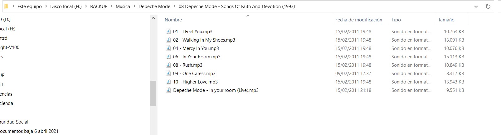

If I go to the folder in my Windows explorer, I can't see them there, not even as hidden files!
Why does FFS keep restoring these jpg files which I insist I want to delete?
I attach the corresponding screenshots.

Your File Explorer screenshot does not show if it is a file listing of H: or G:, but based on the FFS screenshot it seems it must be of G:, not H:.
From your FFS screenshot, it seems you run a (left-to-right) Mirror sync variant.
And in the left side (the source-side) H:, clearly the several *.jpg files exist that do not (apparently no longer, as you state to have deleted them) exist on the corresponding right side G:.
So, as per its setting, FFS suggests to left-to-right sync the *.jpg files "missing" on the right side.
Similarly, as per its setting, FFS suggests to delete the right-side ...marzo2021.rar file, as that file does not (or no longer) exist on the left side.
When running a (left-to-right) Mirror sync variant, all changes made to the left (source) side will by synced to the right (destination) side; any changes made to the right side will not be synced right-to-left, and be overwritten or restored during the sync.
That is: unless you tell FFS to ignore certain files or folders per the Exclude Filter.

How do you arrive at the conclusion that it is FFS that is creating those files (again) in H: ?
The only thing the FFS screenshot shows is that those *.jpg files do exist in H: and that FFS (correctly) intends to copy those to G:. But FFS can not find files that do not exist and does not spontaneously create or download artwork files.
So, if it is FFS (and not some other tool ...) that created/restored those artwork files in H:, it must be the result of some other FFS sync you ran between another location (that does comprise those artwork files) and H:.
Obviously, another option is that you first ran the FFS Compare (shown in the FFS screenshot), then deleted the artwork files from H: (after which you made the File Explorer screenshot) and did not run a new FFS Compare. Then simply click Compare again.
- Posts: 6
- Joined: 5 May 2021
Thanks, I don't think any of those cases is happening here. I am not running any other app and I did not create the screenshot after deleting the files in H (that would be really silly of me...)

You are. Your media player ;-).I am not running any other app
Check the dates of the .jpg's.
It could be your media player is automatically going out & pulling down "AlbumArt".
(What media player are you using?)
Or...
Delete (or rename) the .jpg.
Play the particular (Depeche Mode) song.
See if a new "AlbumArt" .jpg doesn't populate your H: drive.
(I don't use WMP, so can't comment...)
"By default, Windows Media Player 12 will download the album art provided by the Music provider.
To remove the unneeded album art, please double check if the "Retrieve additional information from the Internet" is unchecked under Options -> Library. After that, please go to the music folder and then deleted the "AlbumArt####.jpg, AlbumArtSmall.jpg, Folder.jpg" files you mentioned. After that, restart Windows Media Player 12 and the album art shall be removed."

I can not delete or rename the *.jpg files, as they are not showing in the real H folder. They only show in the FFS interface.
But I have disabled the option you mentioned, so I hope this problem will not repeat next time.
