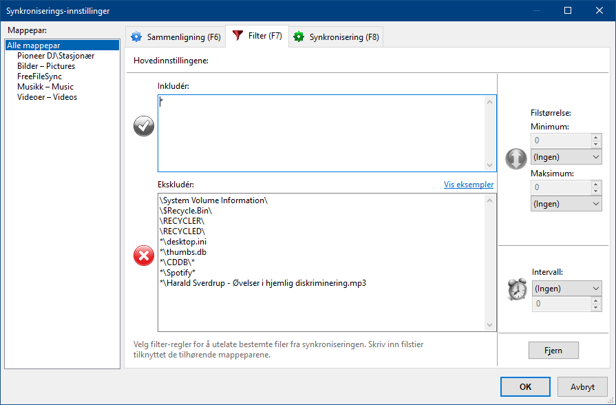

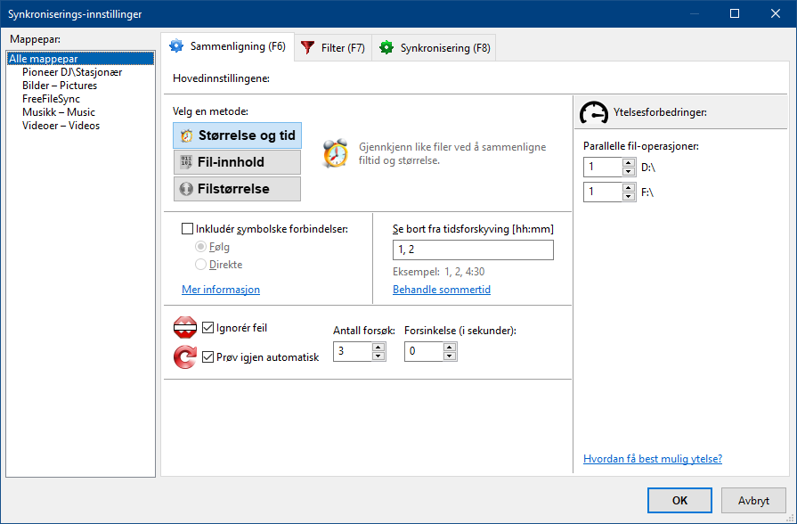

Can you post pictures of:
1- filter settings
2- sync method
3- FFS compare window with the locations you are syncing
I would wager that the empty folder is actually a destination location in FFS
1- filter settings
2- sync method

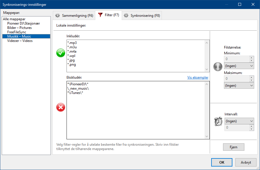

They where subfolder of a folder path synced. Could this be due to filters. The inlude filters only include (*.mp3, *.m3u, *.m4a, *.wpl, *.jpg and *.png) but subfolders are still processed. Strange thing is that I have other "settings" (for backup to other devices) where this is NOT happening (the empty folders where deleted) and I find no differences. For now I deleted them manually - and just wait and see...
