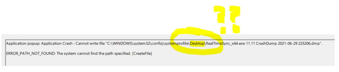

I'm running the portable installation of FFS ... where can I find the *.dmp files? (I was running the local installation type before, and could find the dmp files under my <user> profile directory).
And, after searching everywhere for the dmp file, I think it's not being written...
Indeed, the "Desktop" path does not exist for the SYSTEM account by default, and FFS probably also shouldn't try to create it. The following version implements a work around where the dmp file will be written to the working directory instead. (This is likely the folder that contains FreeFileSync.exe).
